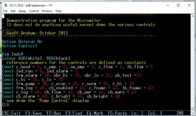

This fixes the bug in delete from a18
AND it includes the Micromite full screen editor
Use OPTION COLOURCODE ON to enable colour editing
and then use the EDIT command as in the Micromite
If required you can still use nano using the command NANO
NB: the editing works well using putty over SSH. There is a problem with Delete /backspace in Teraterm. This can be fixed using OPTION TERATERM ON.
I haven't tested using a console window on a directly connected monitor/keyboard. Feedback appreciated.
