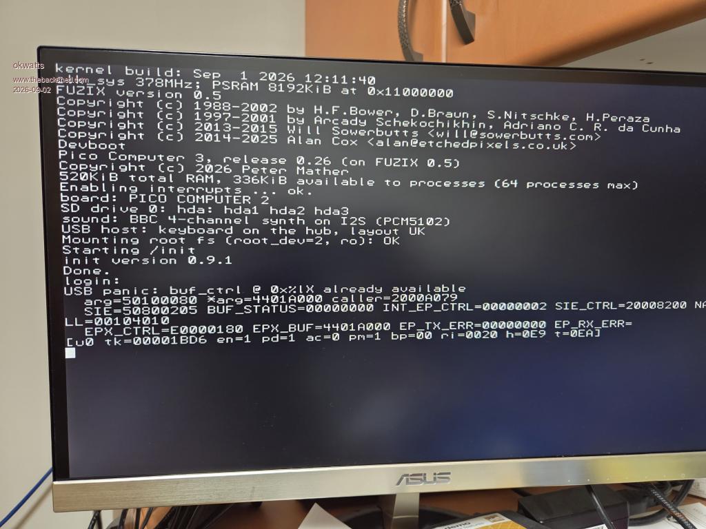

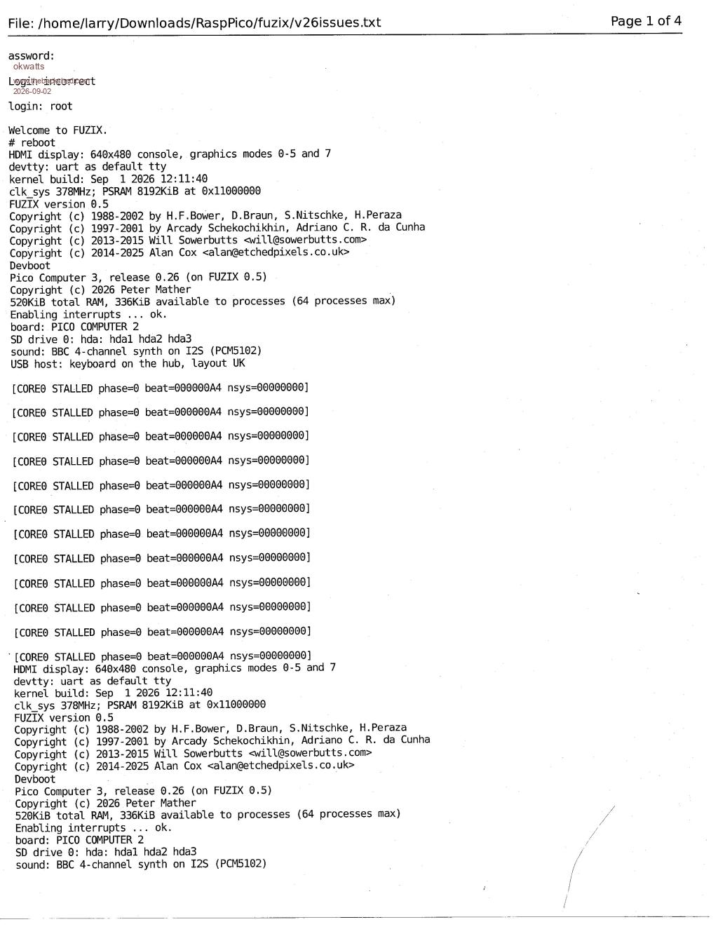

Tried v.26 and now there are new problems with different messages.
There are 2 photos one of the HDMI screen and the other on the console. This is for the Pico Computer 2 but similar has been seen for Pico Computer 3and there are time when the boot goes to completion but the USB keyboard is not recognized either plugging or unplugging or typing.

Fuzix on PicoComputer 3 boots fine and works with USB keyboard. With PicoComputer 2, with USB keyboard attached gives USB panic and Core(0) Stalled messages as show in picture in previous post. If I disconnect USB keyboard and reboot and login from serial console then attach USB keyboard it is recognized and works properly. A reset or reboot gets to login without panic but USB keyboard is ignored.

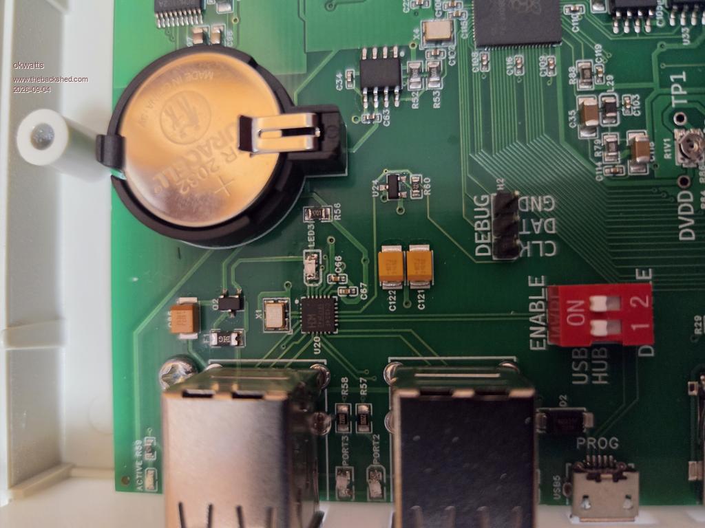

okwatts: can you confirm the pc3 is OK in all tests and this is a pc2 issue? Which version of the pc2 do you have - please post a pic of the area round the usb hub chip

Okay I did try a number of combinations. I have my one PicoComputer 3. I have 3 PicoComputer 2's that I have been using, 1 each for Fuzix, Micropython and MMBasic all from the same batch from JLCPCB. I will attach a photo of the Fuzix one.
I think I found an issue that was occuring! In sorting through my various combinations I was consistent in my use of USB keyboard, HDMI and Headphones between all boards. The one thing that varied randomly was I had 2 USB C power cables. It appears that one of them (slightly thinner in diameter) was causing most of the grief. It didn't seem to affect the PicoComputer 3 but it did cause unpredictable behaviour on the 3 PicoComputer2 at least on powerup with the USB Keyboard. Once I had unplugged the USB keyboards and let them boot then inserting the USB keyboard worked across the MMBasic, Fuzix boards. It's possible that the power was not settled using the one suspect cable during startup. The other consistent difference for the PC2 boards was that when I ordered them JLCPCB were out of stock for the green diodes for LED3 and the Port indicators. I sourced them from LSMC and soldered them in myself. It is possible that my soldering was not the best especially for LED 3 which feeds the USB chip.
In any event I include a picture of the area around the USB hub chip and will be careful with power/console cables and keep my fingers crossed that that is the end of the lesson and story.
