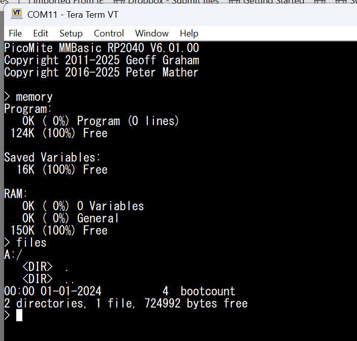

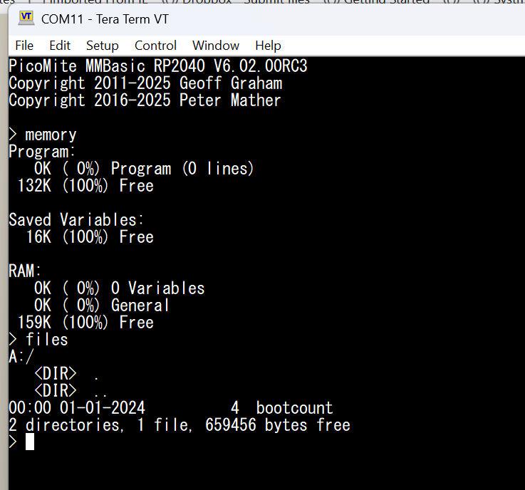

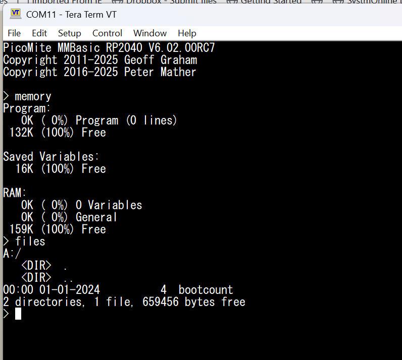

Posts: 6195
Posted: 07:07pm 18 Jan 2026
@Peter,
As much as I like you improving 6.02.00 with additional features, could you please revert back ?
On the RP2040 microcontroller version, we lost 48k of A:/ drive on rc7 versus rc3. This is killing Game*Mite.
To me it does not look like the additional I2CLCD commands and BITSTREAM  would take that much flash, but fact is that it does.
Thank you in advance,

For the avoidance of doubt. There is NO change between RC3 and RC7 in the size of the firmware. In both cases it is 53 16Kbyte blocks = 848Kbytes and the size of the A: drive is identical (6.01.00 was 816KBytes) . The images are taken from firmware downloaded from this thread.
What did change before RC3 is that I finally implemented GUI controls properly meaning that if OPTION GUI CONTROLS isn't set they use no memory. This released extra memory which was added to the MMbasic heap increasing it, in the case of the RP2040 Picomite from 124K to 132K which gives more space for arrays, framebuffers etc. This also increases the maximum program size. As a result the flash image of the program and the flash slots all use more memory reducing the size of the A: drive.
Taken together compared to 6.01.00 the size of the A: drive is reduced by exactly 65536 bytes = 64K- just less than 10%.
I do not intend to reverse these changes, either to remove functionality from the RP2040 (possible savings 32768 bytes) or reducing the heap size (the other 32768 bytes).
I'm sorry Harm, but it is not reasonable to have development stopped by the ability to put x number of games on the A: drive just to support then Game*Mite. There are multiple Pico clones out there with more flash memory than the original Pico and of course the RP2350 is fully compatible and comes standard with 4Mb. If the original Pico is so important surely you can find a way to save some file space by crunching programs, swapping bmp to jpg etc.
I am fully committed to ensuring the new releases are backwards compatible from a functionality perspective.
