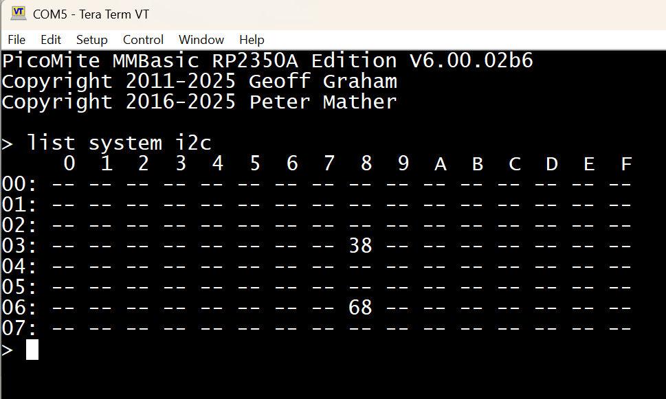

Posted: 12:07pm 01 Feb 2025
V6.00.02b6 now available
Includes support for FT6336 capacitive touch chip
OPTION TOUCH FT6336 IRQpin, RESETpin [,BEEPpin] [,sensitivity]
sensitivity is a number between 0 and 255 - defaults to 50, lower is more sensitive.
SDA and SCK should be connected to valid I2C pins and set up with OPTION SYSTEM I2C
TOUCH function works as before + TOUCH(X2) and TOUCH(Y2) returns the position of a second touch location or -1 if no second location is touched.
New commands
Support for all PIO commands as per post above. Note that labels required must be identified with the directive ".LABEL" in order to differentiate them from MMBasic labels
LIST SYSTEM I2C
Produces a display showing the addresses of all I2C device connected to the STSTEM I2C pins (another sneaky bit of embedded Basic)
Edited 2025-02-01 22:08 by matherp

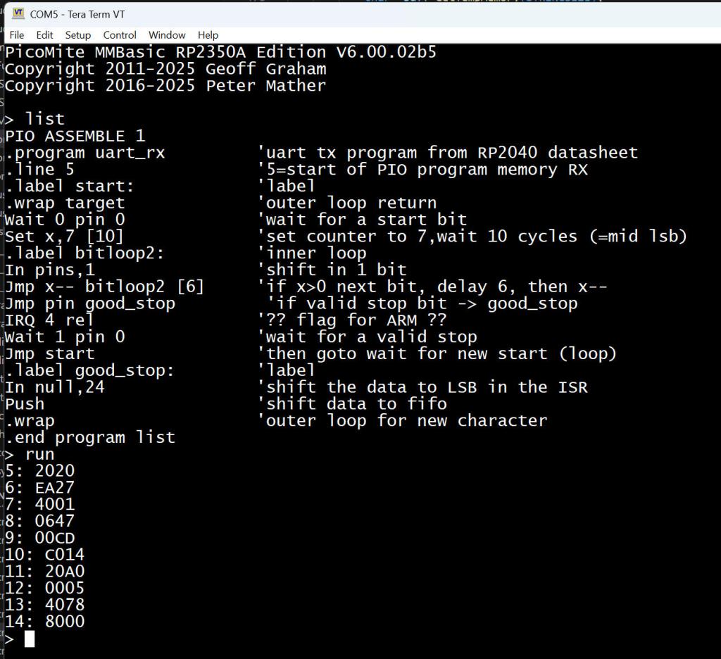

Posts: 6197
Posted: 02:44pm 01 Feb 2025
Hi Peter,
Sorry I was not in position to test earlier. I was at a concert last afternoon/evening...
I am not sure this PIO assembler change is backwards compatible, but it feels (from your explanation) that .WRAP it translated into _WRAP. This has impact on the PIO handlers.
Please find attached code (runs fine on b5) that throws an error.
RUN
0: A02B
1: 20A0
2: 0043
3: 00C2
4: A0C9
5: 8000
[149] puls_wrap=Pio(_wrap)
Error : Syntax
The code (is far from finished) it this:
fc2_v02.zip
I tried the new assembler format, and the issue is the same.
fc2_v02_new_asm.zip
I tried replacing .WRAP with _WRAP, but that does not help. I think under water the PIO helper still checks for .WRAP and not _WRAP.
I have another question. In the original program i implemented the "debug" variable that shows the disassembly listing yes or no by changing the string. Is this portable in any way to the new assembler format ?
Edited 2025-02-02 01:01 by Volhout
Posts: 12059
Posted: 03:00pm 01 Feb 2025
Easily fixed - will post an update later this afternoon. To carry on testing just global replace _wrap with wrap in the variable names

  matherp said  V6.00.02b6 now available
LIST SYSTEM I2C
But there might be different slave`s SCL speeds...
My MMBasic 'sand box'
Posts: 12059
Posted: 03:35pm 01 Feb 2025
SYSTEM I2C can be set to 400 or 100. It's up to the user - see manual. Obviously set it to the speed of the slowest device. Nothing to do with this command
