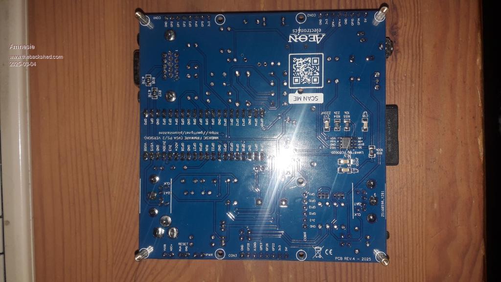

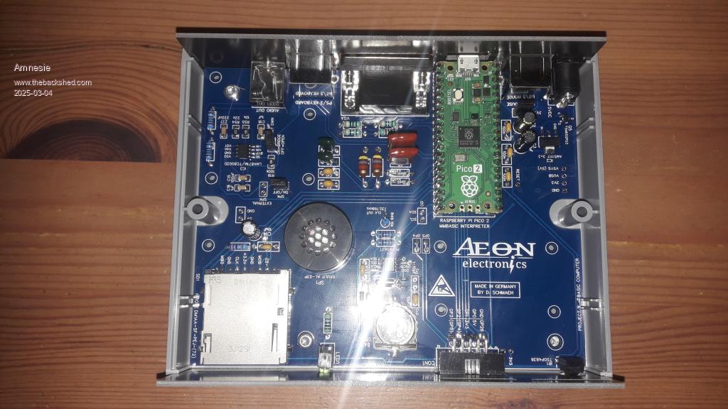

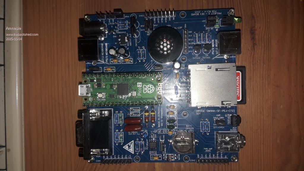

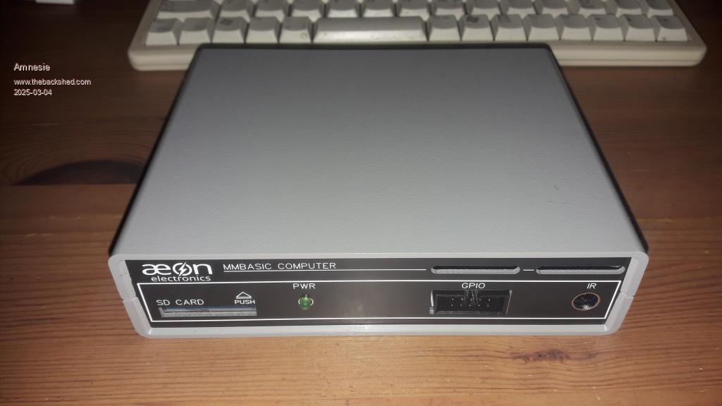

Hello, sadly the answer is no. Since they don't fit my needs to 100% for various reasons (choice of components, track routing etc). I decided to design my own PCBs but mainly focus on VGA versions of the PicoMite. I don't really like the fact, that HDMI isn't really supported but kind of works on MOST devices and monitors. Don't get me wrong, this is cool enough, but VGA is more solid. So I am not sure if I ever come back to that HDMI-PCB-project .. at least not for the PICO 2. It is just not made for HDMI, this is also what Peter said. Cool and some kind of magic that it works at all, but this isn't good enough for me. (for me) it MUST work on ALL devices, period. But I am super happy with VGA mode   If you need PCBs for that I have a lot of them even with onboard power amplifier and mini-speaker + changeable colour palette from standard to windows 16 colours, which includes grey.
I have two versions made; one like an arduino the other is to fit nicely in a case:
Both have a built-in speaker (of course you can disable it via jumper) Both have PS/2 Mouse support!
I don't want to hijack this thread, so If there is interest or such, just write a PM.
