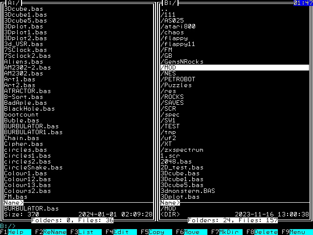

  Amnesie said  Hello,
quick question: Is there a mouse support (ps2/usb) for the file manager yet? I think this would be an improvement if not already built in   Drag 'n Drop from one DIR to another or copy etc...

  javavi said
  Amnesie said  Hello,
quick question: Is there a mouse support ...
I thought about it, I plan to make multi-selection ...
"multi-selection" would be great!
Kind regards

Hi Vadim,
I'm glad you like the improvement as much as I do. Unfortunately I had to make a few small changes. I had also thought about finding better keys for sorting. In my opinion there is nothing wrong with using normal letter keys (n, d, s) - temporarily. As long as they are not used for other things. I installed it once, a little awkwardly, as a test. I like it that way. How do you like it?
fm1172.zip

Updated FM a little to version 1.21
+ Alt works from USB keyboard
+ Stop playing track with SPACE
+ Working on F9 Menu
FM121.zip

Updated FM to version 1.23
FM123.zip
+ works from USB keyboard
+ Sort Order - [BackSpace] switch key (???)
+ and other code optimizations
Perhaps someone can suggest a more convenient button for switching the sorting order?
Thanks to @twofingers for the method of sorting files, I honestly spied on you
Although this sorting noticeably slowed down the update of the disk panel with a large number of files.
Other tips for improving the program interface are also accepted.

  javavi said  Perhaps someone can suggest a more convenient button for switching the sorting order?
Have you considered using CTRL+[A-Z]. I think these plus a few other combinations produce the lower ascii codes 0-31. Just don't use CTRL+C. Maybe CTRL+S(ort). Should also work from VT100 terminal.
