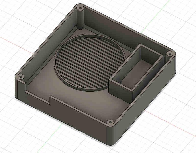

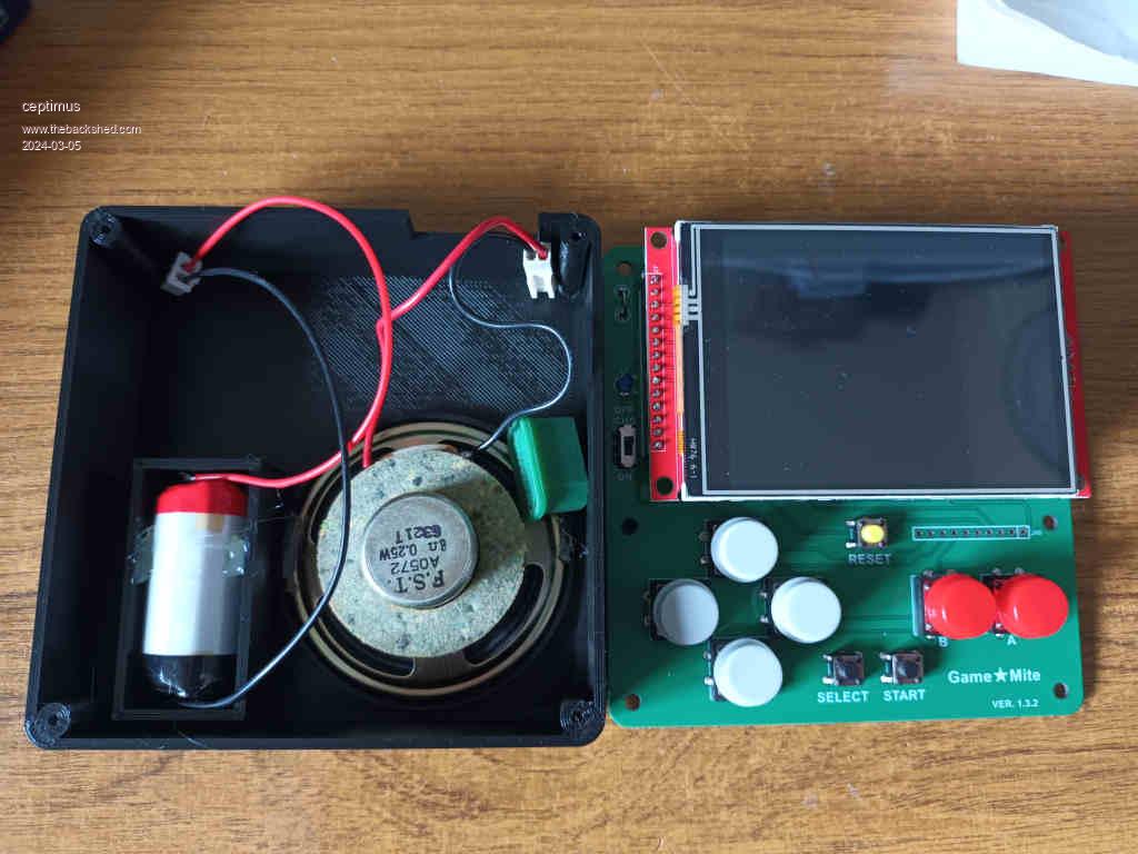

I bought a kit from Tom (thanks Tom), and enjoyed putting it together.  I powered mine from a Li-ion cell I harvested from a discarded vape I found littering the street.  It's a round 1500 mAh cell, so a little larger than the type Tom recommends.  That meant there was no need to worry about the size of the speaker, and I found an old 2-inch diameter speaker in a box of bits - probably I took that out of a broken transistor radio, or clock radio, years ago.
I designed and 3D-printed a case (back) to hold those two bulky items, and put some slots over where the speaker cone fits, to 'let the sound out'.
It works great.  When I get a couple of current, non-mite, projects completed I intend to port some of my previous Colour Maximite (version 1) games to it.  I'll probably start with my Manic Miner port.
If anyone wants the 3D-printed back STL files (or Fusion 360, if I can work out how to share those), let me know and I can upload them to Thingiverse or similar.
STL File would be great
you can zip it and upload it here
Edited 2024-03-05 00:38 by Martin H.

Posted: 02:42pm 04 Mar 2024
Here you go.
3D-print_Game_Mite_back.zip
You can see in my photo, I just used some dabs of hot glue, from a hot glue gun, to hold the battery in its 'box', and to secure the speaker.
The greeny-coloured thing lying by the speaker in the photo is just a rubber cover for an XT60 power connector that shouldn't be there - it fell off a shelf and landed there when I was about to snap the photo!
Edited 2024-03-05 00:47 by ceptimus
Posted: 02:52pm 04 Mar 2024
Thanks for sharing @ceptimus, I love to see the variation in the final builds.
Could you just confirm that the 2" speaker was out of choice, not necessity. I did include one of my little rectangular speakers with your kit didn't I ?
ceptimus
Joined: 05/07/2019
Posts: 130
Posted: 03:12pm 04 Mar 2024
I was about to post that I don't think I did have the little rectangular speaker, but I double-checked before posting, and found it lying amongst all the junk on my soldering desk!
The leftover bits from the kit, I think, are that speaker, a VER.1.3.1 backplate PCB, some stand-offs and a few lengths of header pins.  I'll likely fix the track shorts on the 1.3.1 'backplate' board and build up a second Game*Mite.  I think I have all the parts I need lying around, except for a PAM module, a volume control pot, and the large push buttons - I'll get those from Ali Express or Ebay.
The speaker I actually used, I just measured again, and the outer frame is actually about 57.5 mm diameter - so a little over two inches.  I've no idea where I got it from, or whether that is a 'standard' size.  It sounds good in the Game*Mite though!
Edited 2024-03-05 01:16 by ceptimus

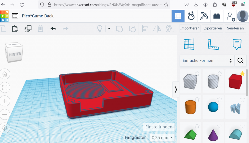

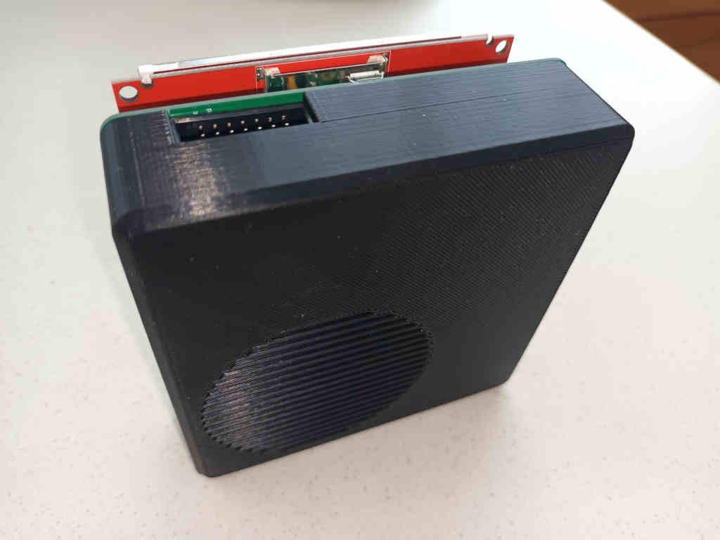

Posted: 07:36pm 04 Mar 2024
  Martin H. said
because my battery and speaker have a different shape, I will have to edit it before printing anyway.
Cheers and Thank you very much,
Martin
If I've understood it right, this link should allow anyone to access and edit my Fusion 360 design. https://a360.co/3TmWbG3
Don't worry about changing it - I already have a copy of the .stl, and if I want to make any substantial changes, it wouldn't take me long to just start over from scratch.
But maybe it doesn't allow editing?  I don't really understand what can, and cannot, be done using the free-to-use (hobby) version of Fusion 360.
Edited 2024-03-05 05:42 by ceptimus
Martin H.
Joined: 04/06/2022
Posts: 1573
Posted: 07:46pm 04 Mar 2024
  ceptimus said
Martin
No, i edit the copy of the STL File which I downloaded with your ZIP File, so your Source doesn't change.
If I download a Textfile from you and edit it, your file also will not change ;-)^
here my more slim version:
Pico Game Back.zip
Edited 2024-03-08 22:13 by Martin H.

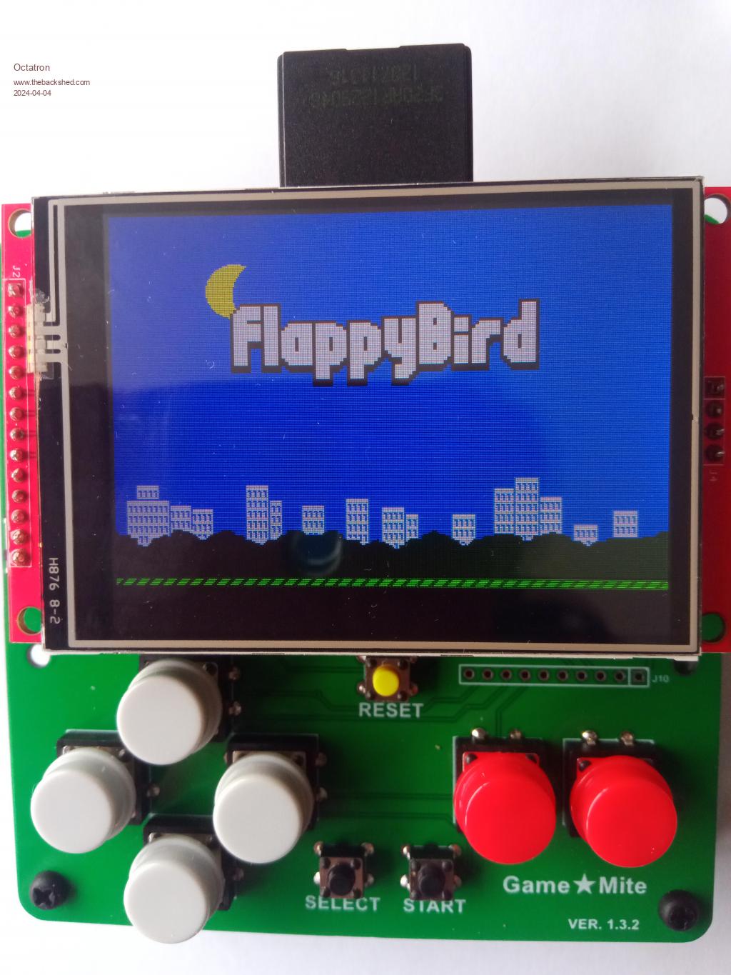

Posted: 01:41pm 04 Apr 2024
Another Successfully Completed Game*Mite Kit
I enjoyed building Tom's kit, he has done a good job of collecting the parts together, even marking up the resistors.
A couple of questions.
Is there a way of transferring files from Drive B: (SD Card) to Drive A: (internal memory)? I checked the manual but couldn't see any mention.
Is there a USB PicoMite version for Game*Mite? It would be good to attach a keyboard to it for editing etc.
Also it would be good to see some games or other programs using the touch screen on Game*Mite. I don't think I have seen any yet but I may be wrong.
Posted: 02:19pm 04 Apr 2024
  Octatron said  Another Successfully Completed Game*Mite Kit
Thank you for posting your build.
  Octatron said  Is there a way of transferring files from Drive B: (SD Card) to Drive A: (internal memory)? I checked the manual but couldn't see any mention.
The Game*Mite hardware is just a standard PicoMite with specific display, audio and some buttons. As per the normal PicoMite you can attach a PC via the USB connection and then use a terminal program (e.g. 'Tera Term' on Windows, 'screen' or 'PutTTY' on Linux or Mac). Once connected you can use the MMBasic console to copy files around. Alternatively use @TassyJim's MMEdit. Eventually I hope to provide tools of my own that will run on the Game*Mite and support basic operations such as moving files between A: and B:
  Octatron said  Is there a USB PicoMite version for Game*Mite? It would be good to attach a keyboard to it for editing etc.
It's not on the cards from me. Use a terminal or MMEdit as above. Note you can't attach a PS/2 keyboard to the user-port, the required pins (GP8 and GP9) are not free.
  Octatron said  Also it would be good to see some games or other programs using the touch screen on Game*Mite. I don't think I have seen any yet but I may be wrong.
It would be good to see some more games full-stop .
To be honest the touch-screen doesn't really fall within my concept of the Game*Mite, but there was no good reason not to wire it up, so I did.
Currently I'm porting Akalabeth (Ultima 0) starting with @vegipete's CMM2 version, but I'm doing it the long way around by way of getting it to run on MMBasic for Linux first .
Thanks again for buying and building one,
Edited 2024-04-05 00:24 by thwill
