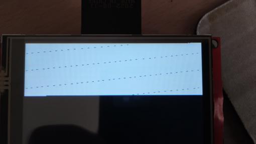

I've got the "pet8.bas" example with the "petsciiLCD.bas" addition running under RC4 on a PicoMite with an ILI9341 and I'm getting this when I RUN:
Any ideas what stupid mistake I am making ?
Edited 2023-09-27 20:51 by thwill
Posted: 10:58am 27 Sep 2023
OK, it's caused by the background copy of L to N; I added a PAUSE 100 after that and the problem went away.
Now I just have to determine why there is no player sprite.
EDIT: It's really very impressive in what has been achieved in such a short time - Well done!
Edited 2023-09-27 21:03 by thwill
