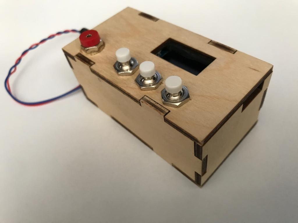

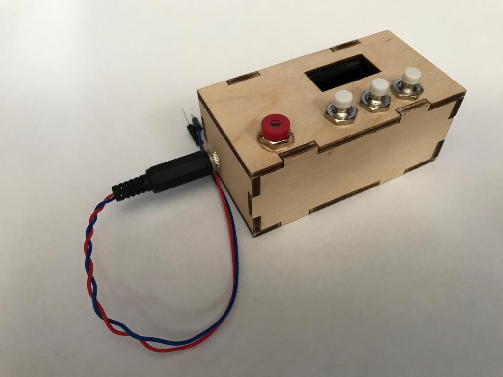

Hi, Mick -
First of all, those are beautiful PCB layouts!
I've made one change since my earlier code dump. Here it is, plus some other thoughts, and the reasons for them:
1. I've shifted button inputs from GP15, GP14, and GP13 to GP14, GP13, and GP10. I have a copy of the Adafruit Pico pin map; it says not to use GP15 / pin 20 (for unknown reason). All other intervening pins are in use for various board functions.
2. Rather than have a switch to select AC or DC inputs, I just have the input line run to the jack, and will capacitively isolate (with the pull-up and pull-down resistors) externally. Thus far, I haven't added any resistors or other protection to the input on pin 31. Living dangerously works for me, but I appreciate you being more careful.
3. As you did in your board layouts, I just have it brought out to a test point (red socket) accessible to the input "probe". Same goes for output protection on pin 24 - living dangerously.
4. Personally, I'm not using a power switch, as I have a tiny LiPo battery directly connected to the JP2 receptacle on the RP2040-LCD-0.96 board. While the board is plugged in to a USB-C cable, the scope is operating and also charging the battery. When I want to isolate the ground, I'm just unplugging it from the USB-C cable, and it runs for two or three hours (!) on the LiPo battery.
In these photos, I've just made all the connections between the switches, jacks, and the board via soldered wires (at the switch / jack end) and female header connectors (at the board end). The wooden case was cut on my neighbor's laser cutter, and I've mounted the board inside using Sugru, not the most elegant solution in the world. I *do* very much like the notion of front-mounting the PCB with the RP2040 board installed on it.
My intent is to paint the wood, then put labels on the jack, test point, and buttons.

1. You can't use GP8, GP9, GP10, GP11, GP12 or GP25 as these are used for the display (and GP25 doesn't come out to a pin anyway, it's normally thee on-board LED).
I can't see where GP13, GP14 or GP15 are used on the module...?
2a. If you don't want the AC/DC switching leave off the cap, button and 4k7 resistors. Link the bottom two holes where the button goes. Done. :)
2b. I'm very loath to have a flying lead on an ADC pin without protection. For static reasons if nothing else. It costs virtually nothing to do and the idiot that finds 9V on the probe instead of the expected 3V may not blow the Pico up. If you *must* live dangerously fit a link instead of the 2k2 resistor and leave off the BAT85 diodes. :)
3. The attenuator on the output test signal isn't for protection, it's to drop it to the standard 1V level that you usually find. You can, of course, mess with the values or even link the 1k8 and omit the 820 if you want the full 3V3. I like a lower level that can be used for simple audio testing (and can be fed into a 8R earpiece without damaging the Pico, of course).
Edited 2023-08-26 18:34 by Mixtel90

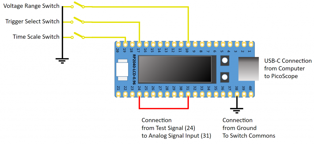

Mick has sensibly added protection circuitry to the inputs and scaling circuitry to the test signal output, but here is my "barebones" circuit diagram:
Unfortunately, the RP2040-LCD-0.96 doesn't have a touch screen. That would eliminate the need for the external pushbutton switches.
The PicoScope code runs pretty much without any changes on a Waveshare Pico-Eval-Board, but you need to set up its display appropriately with OPTION commands. Unfortunately, the P-E-B doesn't have i/o connections run out to accessible connectors. On the P-E-B, I set the analog input to that of the light-dependent resistor ("LDR" in the circuit diagram), and blink NeoPixels at it to view the resulting waveform.
This all started out for me as an exercise in exploring PicoMite and WebMite variants of MMBASIC, and has since taken on a life of its own.
