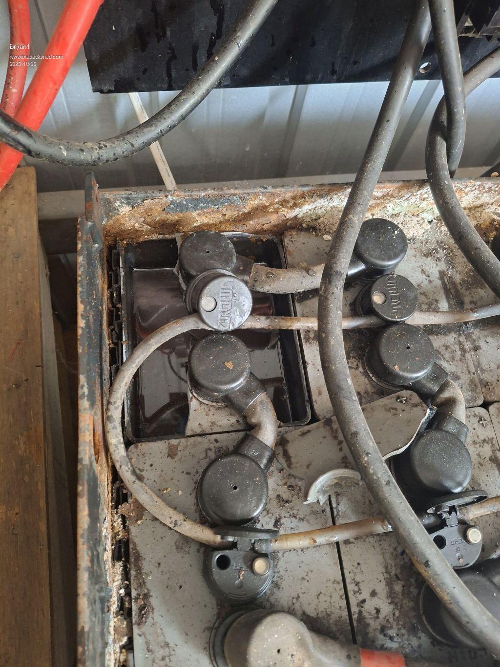

Well while I was grinding some 1.5mm gal plate for the back cover heard a bang and found some black plastic close to my foot, couldn't see what it was so just kept going and the sparks were no near the battery either.
Just did a voltage check and the battery is still holding voltage so that is a good sign   Now there is another battery where the lid is raised and I can't really complain as I did get this battery free back in 2012
Now I do think with this build some Ceil 1000AH cells may be needed to replace this battery. I will stay on 24 volts too as can't see the justification of spending all that money just to go on 48 volts.

That's a bit nasty Bryan and I'm glad they didn't all go off.
I'm in a facebook group of forklift battery users and one of the guys had his blow up  ...  and he successfully stuck them all back together again using hot glue. Some were cracked down the sides and glue even sealed them too.
Also a reminder for me to not be too casual around mine. I keep a fan running over them while they are charging but I also need to be aware of not creating sparks with charging leads etc.

Well good news on my shed battery as that cell that blew it's lid is still good and the batteries are fully charged for the weekend

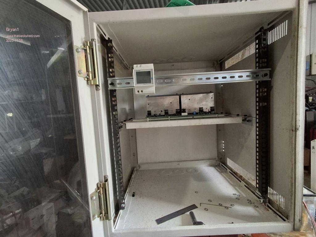

Anyway installed a din rail and got onto ebay and bought a energy meter the same as Rogers   so for the AC output I will put in some circuit breakers along with that energy meter so got a visual of whats going on.
As the brain board still needed the nano soldered in got it all setup tonight and hoping if all goes well tomorrow got 60+ soldering joints to do, ain't soldered circuit boards in ages so time to get back in the swing I think.
Now for the main driver board I did find some old brackets to fit the job   so by using the outer holes on the circuit board will allow the the battery connections to pass under between the gap and just need to bend up some plate to mount them.

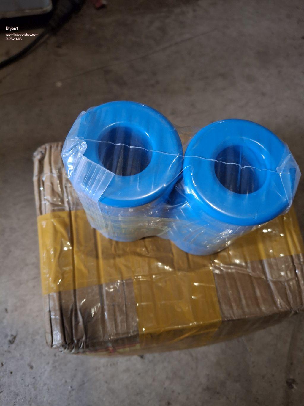

Got an email stating this package had finally arrived so picked it up after work along with my new Tee shirt from ARSE
So I do think a stop tomorrow after work to the 12 volt shop to buy a few metres of 35sqmm so winding the toroids can be the job Saturday after work
Now a question for those that have done these chokes is it best to glue the toroids together to make one long toroid which I do think will make winding it easier.
Also with those 400mm long 18x3 copper strips I am thinking of adding some 6.5X4 wire I have here and with a good anneal I can get it nice and straight then just soft solder them onto the 18x3 as I do think beefing them up with more copper will make a decent bussbar.

Revlac
Joined: 31/12/2016
Posts: 1309
Posted: 08:39am 07 Nov 2025
They look good, no damage either.
Fun making copper buss bars, I looked at some nice thick copper bar available at some local shop, nope not getting any of it at those prices, I still have enough, but in future if we want a fancy buss bar it might be worth melting down some scrap copper and casting our own, finish it off in the milling machine.
Your build is going well.
Cheers Aaron

Great to see they arrived, could you tell me what the code is on the side of the toroid rings? Thanks.
Bryan1
Joined: 22/02/2006
Posts: 2297
Posted: 03:19am 08 Nov 2025
  KeepIS said  Great to see they arrived, could you tell me what the code is on the side of the toroid rings? Thanks.
Well finally finished work for the week and I stopped into Jaycar to get the M3x15mm tapped spacers and missed the cut for the 12 volt shop.
Anyway the code:
MM571060A
21MB1G1
So my aim is to get the main board mounted so it can go on the table and my old Kipoint can under on the shelf. As theres no way the big toroid is going in the case until the case is mounted as it will be heavy to lift.
Well got the main board mounted and I'm using all 8 holes in the PCB so the pcb can sit nice and flat in operation.
The toroid and chokes will sit on the base so the wiring will be nice and close, still got the bussbars to finish and it does look like a Sunday morning with a coffee will a good time to get back working with copper.
Now for the brain board I do have a 240x100mm perspex 6mm thick and it will be mounted on the righthand side so it can hold the brainboard and the buck converter.
That 2mm bit of plate I cut worked out well for holding the heatsink for the TIP35 which can go off the left wall.
I am also thinking that 175 amp anderson connector is a good idea as I'm going to put that 450 amp switch on the negative and a very short cable to the switch as it will be mounted on my main DC power board.

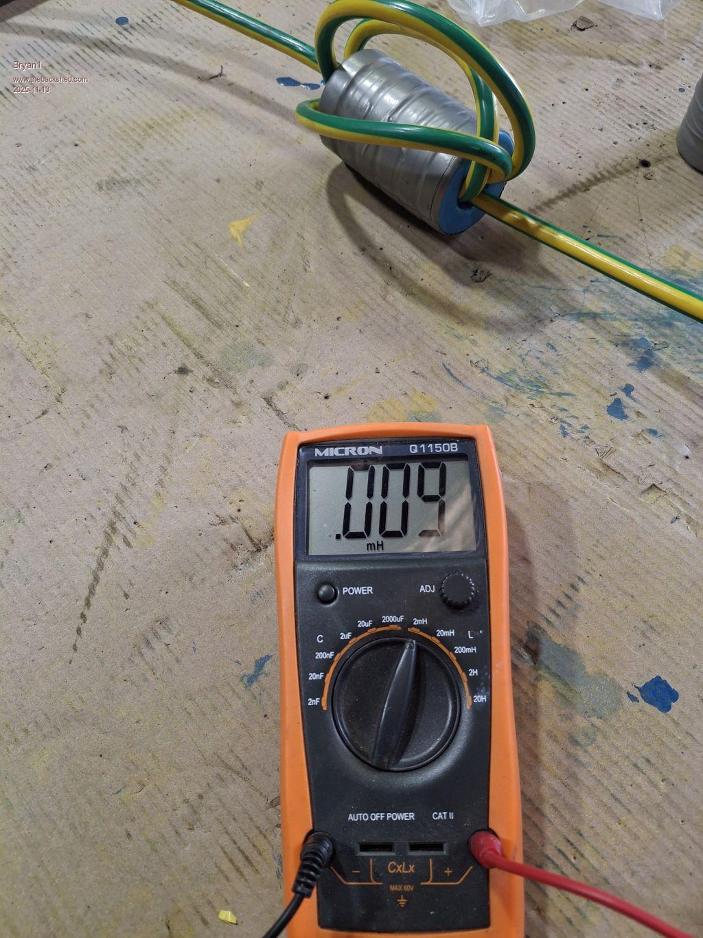

Talking with the sparkie at work today and the talk was on for finding some 35sqmm wire and soon found close to a full roll   then he found 4 off 8mm lugs and did say they had the crimper there so going to 100mm for one end and 350mm for the other end which goes to the main board.
So the question was asked to my boss so tomorrow I'm taking the toroids and my inductance meter then thats another major task out of the way.
Bryan1
Joined: 22/02/2006
Posts: 2297
Posted: 06:35am 13 Nov 2025
Well we did find some time at work and had the first try and soon found the 35sqmm wire was cut too short. So went with a longer length and only got 3 turns thru with no chance of a fourth turn.
I am glad I took my inductance meter to work and several goes did say the same result 9 UH So a question for the brains trust is 9uH too low for a choke.
We didn't bother winding the second one and I do have plenty of 35sqmm cable here to play with, just that it's green/yellow as that what we used. The 35sqmm welding cable has a double insulation and 2 turns will be a test so that why we went with the earth wire.
