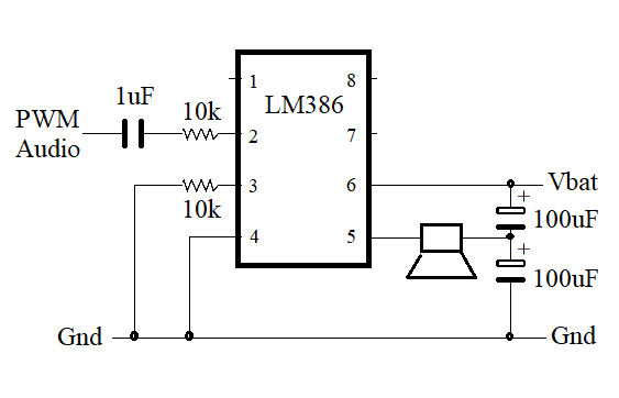

As I only have one chip the speaker is going to ground via a 220uF cap. and is moderately loud. A baffle really makes a difference.
Edit. Further testing.
A capacitor in series with the input reduces distortion.
With a single chip noise is reduced a little if the speaker goes to the junction of two capacitors connected between V+ and Gnd. Might help with other amplifiers too.
Component values not critical.
Pins 2 & 3 are inverting and non-inverting inputs so for bridged output the POKE trick isn't needed, just swap pins 2 & 3 on the second chip. As the PWM phase of L & R are the same both inputs could go to the same pico pin.
chip 1
PWM L to 1uF to 10k to pin 3
Gnd to 10k to pin 2
Vbat to pin 6
Gnd to pin 4
Speaker+ to pin 5
chip 2
PWM R to 1uF to 10k to pin 2
Gnd to 10k to pin 3
Vbat to pin 6
Gnd to pin 4
Speaker- to pin 5

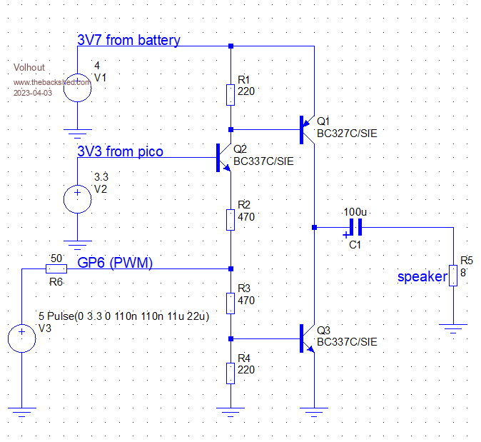

In case you are looking for a half-bridge with discrete components, my simulation say this would work.
The speaker might need a low pass filter (an inductor, maybe capacitor) and a volume potmeter. But this power stage will give you rail-to-rail output with a 3.7V...4.2V battery voltage, and because isolates the 3.3V switchmode ripple, will give you a clean output (as long as the battery voltage is clean). Q1 and Q3 need to be medium power transistors with relatively high gain, such as the BC327/BC337. Q2 can be a standard BC547/BC548 or alike.
Resistor values must be as indicated (R3/R2 = 2 x R4/R1) to minimize crossover (current peaks from battery).

@Volhout: I like the discrete parts only "transistor circuit", what's the "5 Pulse" malarkey on the V3/signal-source ? I'm guessing it is the input to some sort of circuit simulator package ?
@Volhout: In your "diode clipper circuit"
   - Do I still want a 2.2uF cap between the volume/pot and the PAM8403 input, I noticed I have one "left over" on my breadboard from a previous iteration ?
   - Likewise the 2.2R in series on the PAM8403 VDD ? What is/was that for by the way, to my ignorant mind 2.2R is just a bad piece of wire ;-)

1/
The circles at the left side of the schematics are simulator models of battery(4V), switchmode power supply(3V3) and PWM output (44kHz). These are just wires you connect to the succesive circuits.

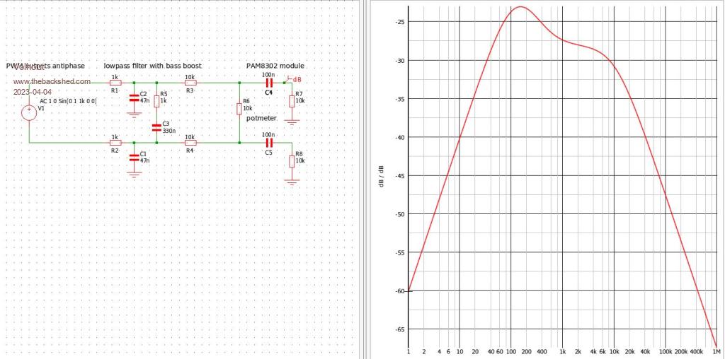

@mozzie,

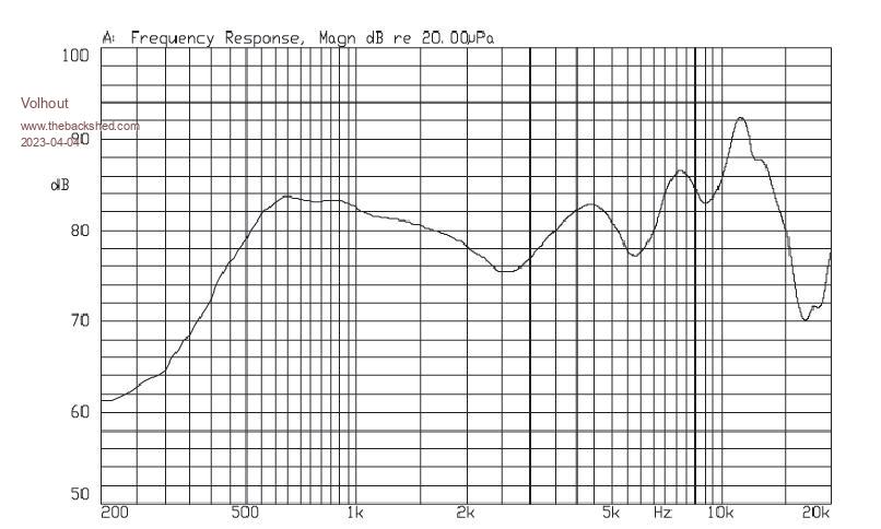

The small speakers Tom has, have terrible low frequency behaviour.
But since the PAM8302 can drive enough power, we could boost the rolloff a bit. Below is an example how this can be done. This is by no means perfect, but the 2 components (R5,C3) boost some 5 db.
The maximum is -23dB (@100Hz), with 24dB gain, the PAM8302 will bring this back to 0dB (2.8V accross the 8 ohm speaker = 0.6 watt).
Edited 2023-04-04 06:04 by Volhout

Tom, there are some specs on that page further down. Frequency range 500-5000Hz.
