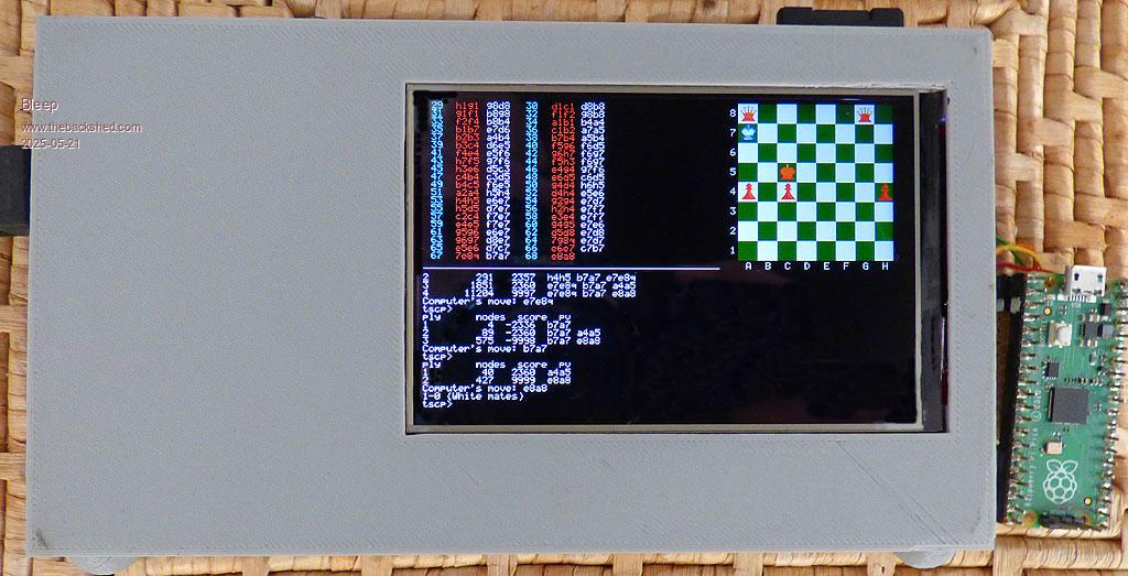

Hi Harm,
Attached is a zip with 3 versions of the Chess client, One for VGA, one for 480x320 LCD and finally 320x240 LCD.
Everything needed is in the "ChessClient" directory (hopefully). The chess client needs to be run from that directory.
The 320 version is a very tight squeeze on that size of screen, but it is fully functional. The only catch is that you only see the command you have typed, when you hit return, otherwise everything is complete I think.
Regards Kevin.

Hi Harm,
That'll be great, I just tested all the versions on RC24 and it still seems to be working. :-) But this latest version must do some extra checking, as it found I was using the word board as a subroutine name and also board$ as a string name and produced an error, so I have now renamed 'board$' to 'brd$' should then be fine.
Regards Kevin.

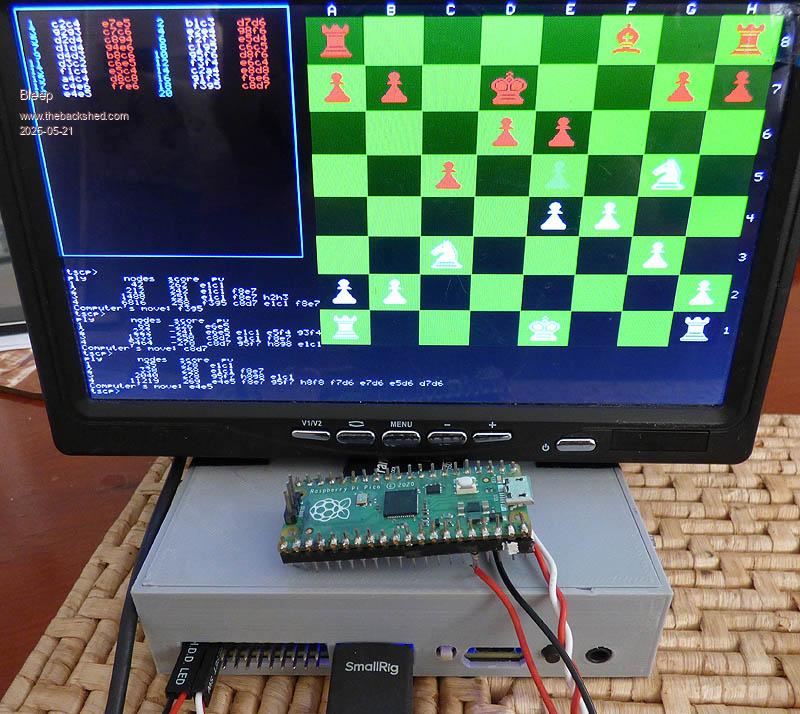

Posts: 6195
Posted: 10:25am 20 May 2025
Hi Kevin,
Have the 640VGA version running now. Works fine. Some minor remarks:
- GP5/GP4 are COM2 ... not COM1
- Dark Blue in the score sheet does not play well with my monitor, I have replaced it with CYAN.
Good work !!

Posted: 03:45pm 20 May 2025
Hi Harm,
Ammendments as suggested by you in new zip below.
ChessClient.zip
Picutures for everyone else.
640x480 VGA on a HDMI screen.
480x320LCD.
Regards, Kevin.

Posted: 04:55pm 20 May 2025
Very nice but I wouldn't mix red and green because many have a problem with differentiating
Posts: 6195
Posted: 05:05pm 20 May 2025
Hi dddns,
These colors have always been this way, but I understand that colorblind people exactly have this problem. In stead of trying all different colors, some don't play well together,maybe a simple Black/white mode could be made through a command "color off". The sprites used are in essence black and white, only the tiles under them change them into colors.
Edited 2025-05-21 03:07 by Volhout

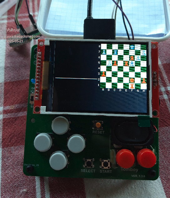

Posts: 6195
Posted: 05:55pm 20 May 2025
@kevin
The 320 LCD version does not show any moves, and prompt.
There is a board, it runs chess (auto) using the PC console.
When playing yourself, you also get no prompt on screen, now moves in the table.
When I read the code correctly it seems you are running the game completely in framebuffer, and you are copying to LCD. Maybe there is one too many FRAMEBUFFER COPY F,N..???
I guess for gameboy we need to talk to Tom to get the on screen keyboard implemented also.
P.S. the gameboy is running 5.09.00rc5. Should I change to 6.00.02 for any reason ?
I guess there is no change in BLIT as far as I know.
Edited 2025-05-21 04:07 by Volhout
