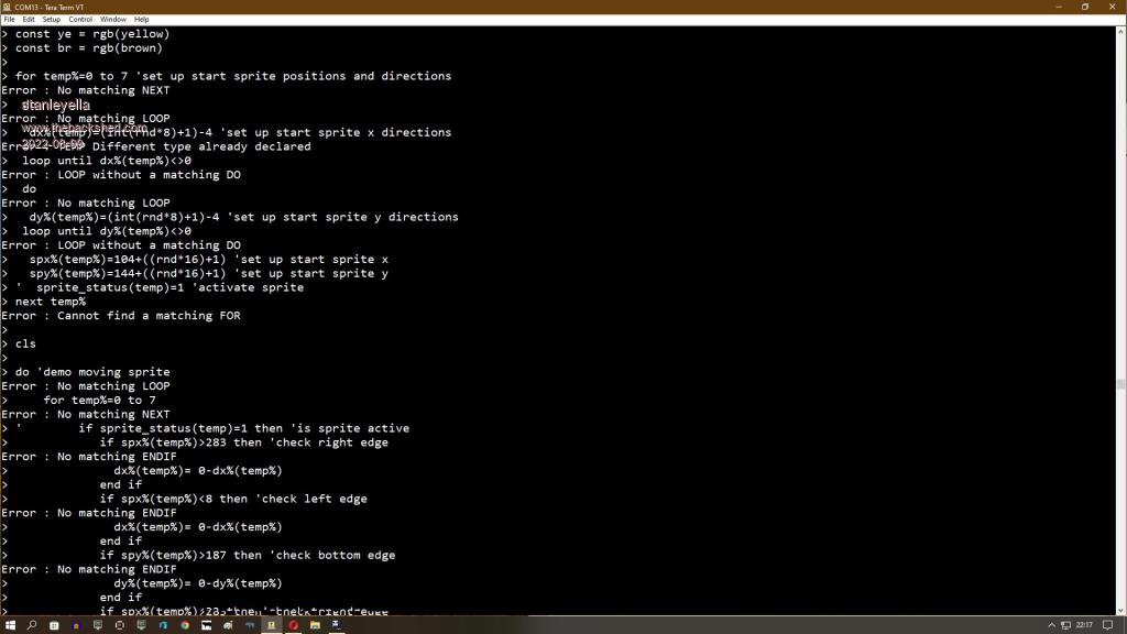

Posted: 05:13pm 08 Aug 2022
Thanks. 5 msec/char and 100 msec/line resulted in all 64 lines being pasted in.
(Now, how do I remember that the next time I paste on a laptop when those numbers haven't been set?)

  lizby said  Thanks. 5 msec/char and 100 msec/line resulted in all 64 lines being pasted in.
2 msec/char and 50 msec/line works for me too (230400 Baud).
I think the slow setup is from the old days of Micromites at 38400 Baud.
  lizby said  (Now, how do I remember that the next time I paste on a laptop when those numbers haven't been set?)
Put a "Post It" on your laptop?
Posted: 08:56pm 08 Aug 2022
The line delay is needed to give the 'mite time to process and save the line.
The size of the delay needed depends on the device. I found 100mS covers most devices. The baud rate also has some influence.
I have found that 0mS character delay and 100 mS line delay suits my collection of devices.

Posted: 09:14pm 08 Aug 2022
If I got 100 lines of code. please how to copy paste it,select all copy. then paste to teraterm and save run assuming teraterm is same com port as rpipico ie com 13.
copying to teraterm gives image
Posted: 09:23pm 08 Aug 2022
You probably didn't start by entering AUTOSAVE
You can either enter AUTOSAVE by the keyboard or as the first line of the code you are pasting
