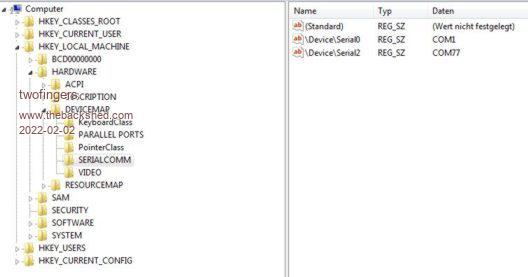

for PortNumber = 1 to 64
Yes please Peter. That should be enough

Posted: 10:38pm 01 Feb 2022
  Chopperp said  ... Yes please Peter. That should be enough
Why?

As Twofingers has shown, the com port number can grow (especially when you have devices with serial numbers).
I started with checking a maximum of 32 to save time but users complained.
The registry method has no such limitations, but it can get antivirus crapware to get alarmed.
