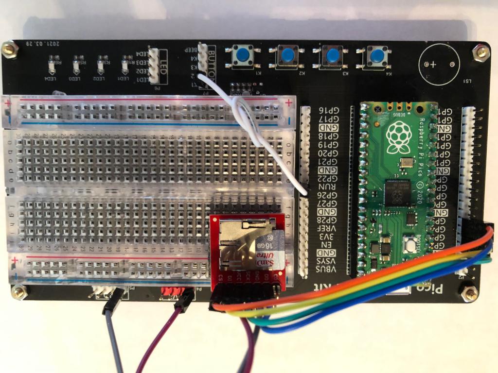

Posted: 01:17pm 06 Jun 2021
I've been testing my astronomy software using alpha version of PicoMite MMBASIC without any serious problems so far. Larger programs such as NPOE will not load and display "Error : The file/directory object is invalid".
Here is a picture of the PicoMite setup I'm using. Reset switch uses button K1. Includes a Sparkfun MicroSD breakout.
