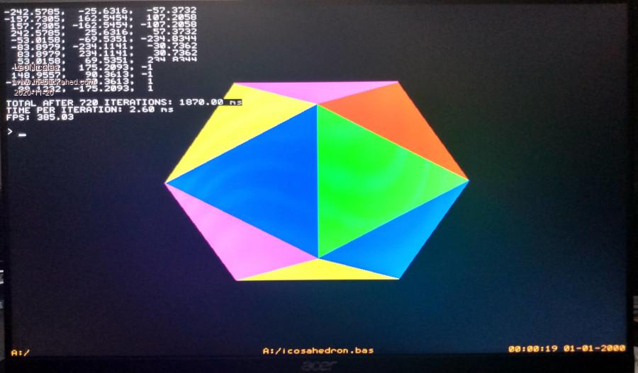

Very cool Vegipete
I copied your icosahedron data to my program. This is the result:
icosahedron.bas.zip

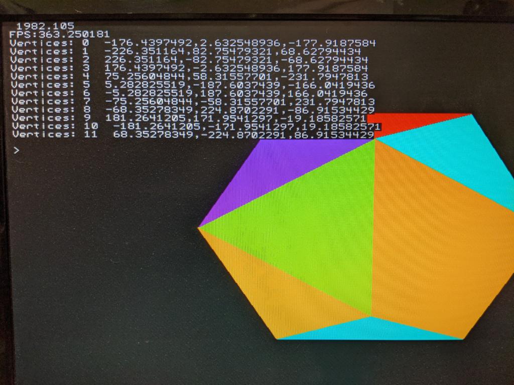

Posted: 04:55pm 20 Nov 2020
Interesting. Although my program is slower than your guys, it does show that there might be some value in the face and vertex symmetry calcs that I put in.
I get 1982ms with the Icosahedron. However if I take out my symmetry calculations it goes up to 2302ms, showing that with primitives with higher vertex/face counts, it does produce a significant reduction in processing time.
Leo, I notice my 650 calcs are different than yours? Not sure why, but the end image looks identical.
