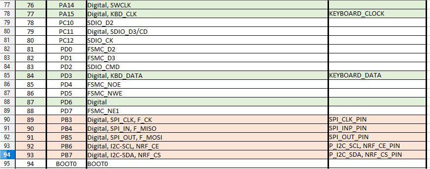

Hi Peter,
I am trying to access the pins on the LCD header, but they all seem to be invalid when trying to access with SETPIN etc.
e.g.
setpin pd14,dout
Error: Pin 61 is invalid
The pin definitions previously posted seem to support this as they show as unused.
I was starting to play with writing a BASIC LCD DRIVER but have fallen at the first hurdle.
Would it be possible to make the following pins available,
36,61,62,81,82,38-46,55-57,85,86,60,88
Gerry
PS I did OPTION LCDPANEL DISABLE, but this did not help.

Posts: 12084
Posted: 11:51am 12 Aug 2019
The LCD pins are always unavailable to MMBasic. They are configured when you enable an LCD - ILI9341_16 or SSD1963_n_16. The Armmite F4 uses the FSMC port on the processor which maps the display as an area of memory.

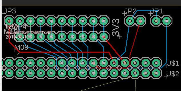

I'm baffled by a problem on a PCB I designed for the F4. Among other things it is set up to read 8 DS18B20s on pins 1,4,5,7,15,16,17,18.
I tested each of these pins successfully with a single DS18B20 3-pin module with built-in 4K7 resistor.
I soldered up my board with a bussed 4K7 resistor array. All the temperatures read fine, but I get "SD card not present" if I issue the FILES command. I tracked it down, and if I don't connect pin 7 (PC13), the other temperatures work and the SD card also works.
I went back and checked with the single DS18B20 module. Each TEMPR command works (pins 1,4,5,7,15,16,17,18), and FILES works after each one.
I wondered if it might be a power draw, but it sits between 65 and 69 mA.
I can find another pin to use besides 7, but I wonder what the reason is for this behavior? (I see that pin 7 has for "Function" "Digital, 3mA total for PC13-PC15", but I'm not sure how this would be related.)
Edited 2019-08-13 07:46 by lizby
Posts: 12084
Posted: 08:39am 13 Aug 2019
  Quote  but I wonder what the reason is for this behavior
I suspect some sort of crosstalk internal to the chip between PC13 and PC12 (SD-CLK). I had huge problems getting the SDcard to work reliably. Eventually I had to use 1-bit SDIO rather than the faster 4-bit and slow the SDIO clock as I was seeing this sort of problem. Could be an issue with the ST driver or, as I suspect, some sort of hardware crosstalk.

Hi guys,
I can confirm lizbys problem with the 1-wire communication on PIN PC13. I use a DHT22 and sometimes I have no connection to the sd-card. If I disconnect the DHT22 the communcation to the sd-card directly works.
Greeting from Germany

Posted: 04:26pm 13 Aug 2019
  SWA-Guy said  I can confirm lizby's problem with ... PIN PC13
  matherp said
  lizby said  but I wonder what the reason is for this behavior
Thanks for the confirmation (and welcome to the forum) and thanks for the explanation (even if the root remains a mystery). Mysteries do abound--I'm glad MMBasic has relatively few of them, thanks to the efforts of Peter and Geoff.

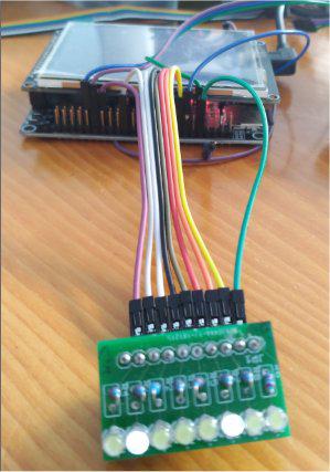

When I hook LEDs up to pins 92,93,89,91,87,84,77,67, two--89 and 77 (PB3 and PA15)-- are on weakly. They respond normally (with brightness corresponding to the other pins) to, e.g., PIN(89)=1 and PIN(89)=0.
What am I seeing here with these pins? After setting them low, "NEW" brings them back on weakly.
Are all of these pins OK to use digitally? Is there a way to have 89 and 77 not doing whatever they are doing upon power-up?
Edited 2019-08-25 01:05 by lizby
Posts: 12084
Posted: 10:07pm 24 Aug 2019
PB3 and PA15 have 10K pullups on the PCB. Remove R1 and R3 if you don't want them
Posted: 03:03pm 25 Aug 2019
  matherp said  PB3 and PA15 have 10K pullups on the PCB. Remove R1 and R3 if you don't want them
Thanks. That did the trick.
option base 1: dim integer i,p(8)=(92,93,89,91,87,84,77,67)
for i=1 to 8: setpin p(i),dout: pin(p(i))=1: pause 500: next i
for i=1 to 8: pin(p(i))=0: pause 500: next i
