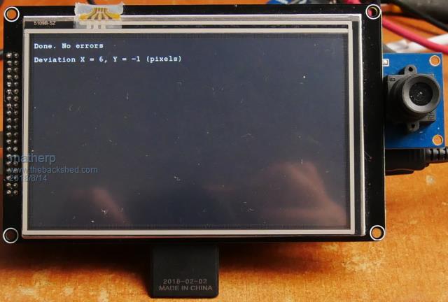

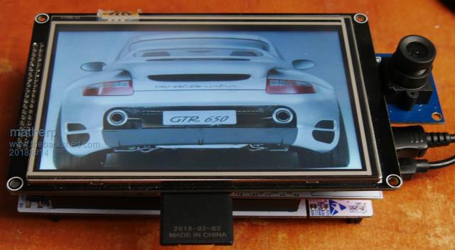

Posts: 12084
Posted: 11:47am 14 Aug 2018
Your card and display arrived safely and the news is good or bad depending on how you look at it
The display and SD card work perfectly on my Nucleo and daughter card. Suggest you look at things like power supply, common ground between supply and USB etc.
The touch implementation on the Sainsmart seems to be a problem. The issue is noise on T_IRQ which looks like a mechanical switch bouncing. What they have done I have no idea. However, I have put some software debouncing into the calibration code without impacting normal operation and this makes it just about workable
2018-08-14_214613_Armmite1.3.zip

Hi Peter,
just done a bit of testing with the new issue 28, and pictures load perfectly now, BUT touch appears to no longer work.
If I run calibrate, message and top left corner appears but when touched nothing happens (actually T_IRQ drops when touched but program doesn't move on).
So what did you do??
PS I have done nothing to my set up here to get these results.
Trevor.Edited by TrevorH 2018-08-16
Posts: 12084
Posted: 04:11pm 14 Aug 2018
Press each calibration point for about a second and the point should then step on.

I have found my Stupid mistake with the touch, I was setting touch to 114,115 instead of 56,123, which is why it was totally unresponsive,
Right back to business, pictures load on small and large screen as they should.
