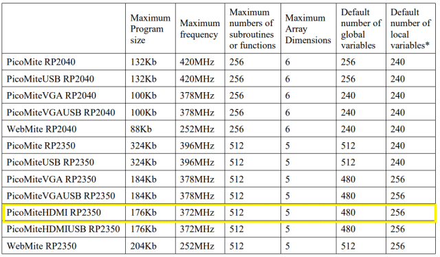

Posted: 03:28pm 19 Mar 2026
I've run into a snag: Too many local variables
  Quote  [LIBRARY] Local INTEGER k, seekPos, linkID
Error : Too many local variables
> ?MM.INFO(MAX VARS)
736
> memory
Program:
 81K (43%) Program (2284 lines)
103K (57%) Free
Library:
 50K (27%) Library
134K (73%) Free
Saved Variables:
 16K (100%) Free
RAM:
 92K ( 1%) 306 Variables
 34K ( 0%) General
6248K (99%) Free
From the manual:
I know it's a big ask, but with the memory resources available with the RP2350, and chance for a further increase in the number of local variables?
Posts: 12056
Posted: 03:36pm 19 Mar 2026
You can trade globals for locals using OPTION LOCAL VARIABLES
Posted: 03:53pm 19 Mar 2026
OPTION LOCAL VARIABLES 500
Perfect. Thank you.
