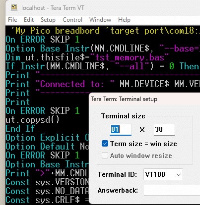

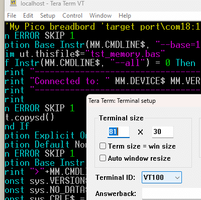

@WhiteWizzard
It appears only to happen if the Term size=Win size option in Teraterm is not checked. I only unchecked this trying to replicate the issue so normally checked for me.
Unchecked.
Checked.

Posts: 12059
Posted: 09:28am 22 Jul 2025
MMbasic always tells the terminal to be 1 character wider than the setting of OPTION DISPLAY. It does this so that auto linewrap in the terminal can't cause problems. Every version of MMbasic I've done does this.
