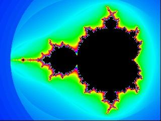

Here is the obligatory Mandelbrot in Mode 4.  RP2350 HDMI
-Carl

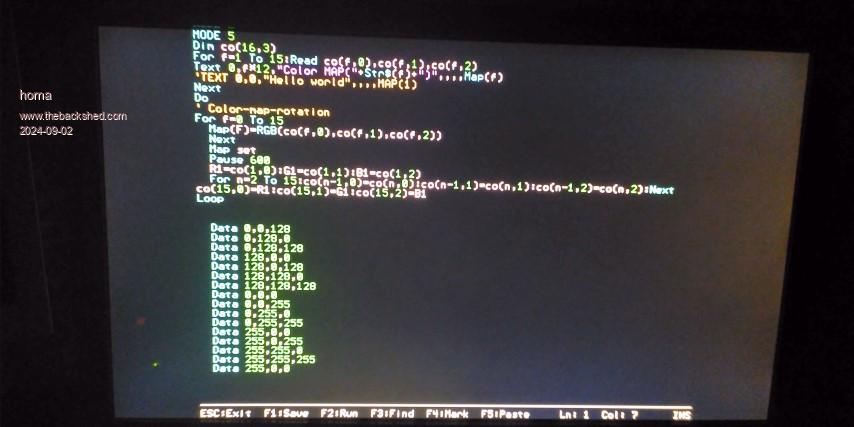

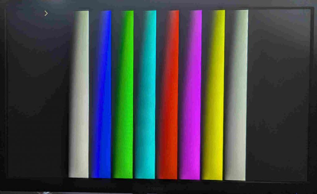

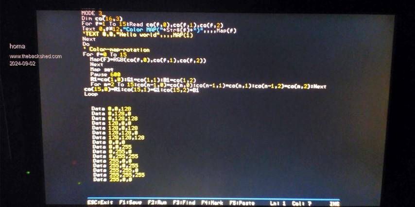

Posted: 09:56am 02 Sep 2024
Hi Peter,
there is still a small bug with the MAP test program. If it is run in mode 3 (works) and then aborted with Ctrl+C, the system colors are no longer correct. Especially in the editor.
On the other hand it works fine in mode 1 and 5 and the system colors are restored there as well.
Anyone else having problems with XMODEM? I cannot send files to the Pico2 (b3). The transfer starts and then freezes ...
it works in the other direction.
Matthias
Edited 2024-09-02 19:59 by homa
Posts: 12068
Posted: 10:10am 02 Sep 2024
This one is a no-win.
If I reset the colour palette after ctrl-C then it is a pain when testing a program that uses it. If I don't then you get the effect you see.
Use MAP RESET to reset the colours before entering the editor in mode 3.
In modes 2 ,4, and 5 the editor automatically switches to mode 1 for editing to get the 640x480 resolution but this is then restricted to font 1 to match the tile size in order to get colour coding
Mode 3 is already 640x480x16colour and therefore colour coding is available with any font.
A compromise would be to just reset the palettes when entering the editor but leave them after ctrl-C at the command line leaving it up to the user to issue the MAP RESET if they wish
