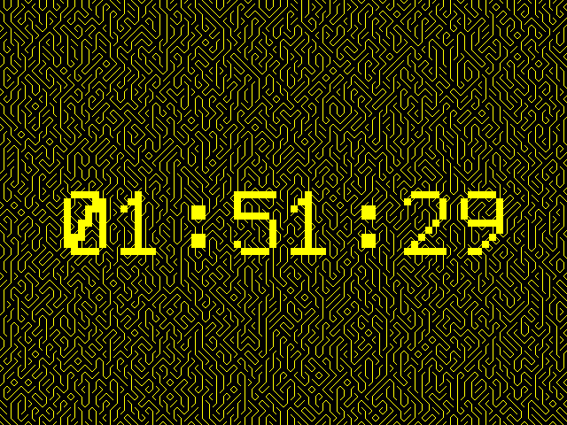

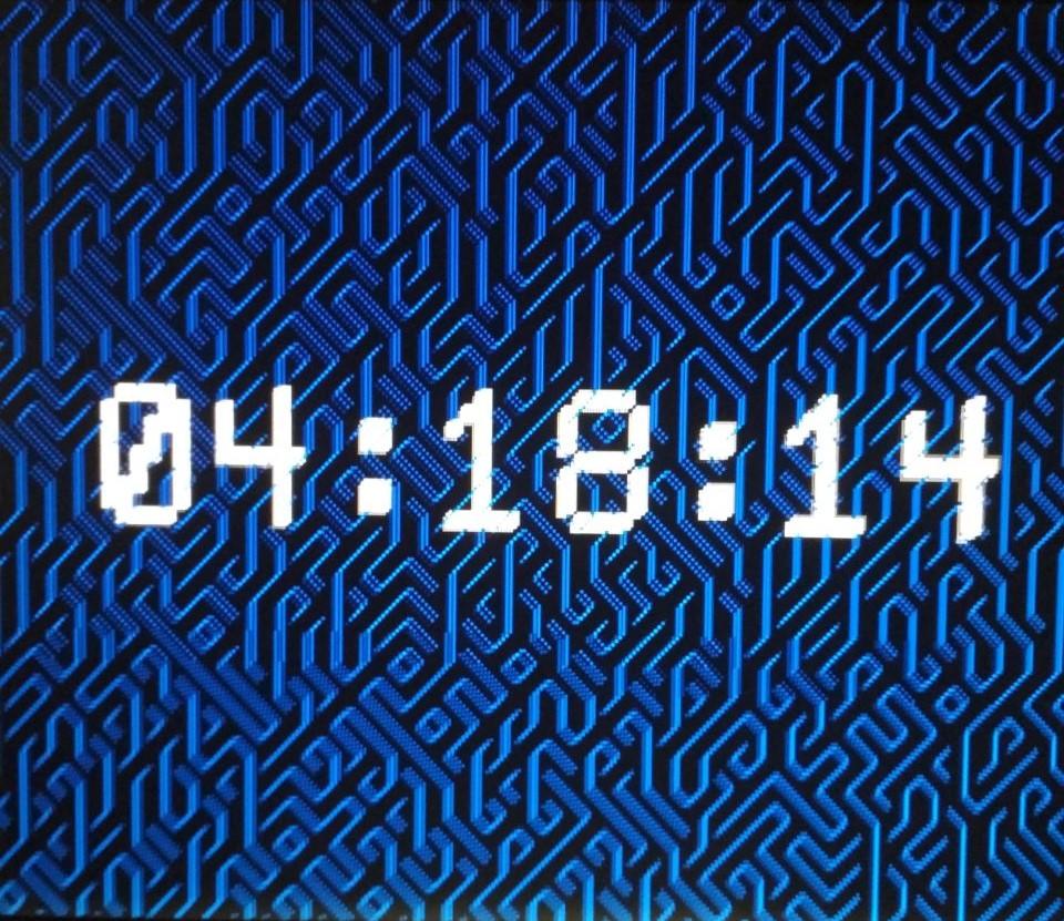

Maze-Clock
MODE  1
Const X.Res=MM.HRES,Y.Res=MM.VRES
Const Font.Addr=MM.Info(FONT ADDRESS 1)+4
Dim string  CH$ LENGTH 1
Dim string  ST$ LENGTH 8
Dim integer X.Dir=1,Y.Dir=1
Dim integer X.Pos=5,Y.Pos=15
Dim integer n,FC,BC
Dim CM(15)=(0,1,2,3,4,5,6,7,8,9,10,11,12,13,14,15)
Colour Map CM(),CM()
Font 9
Print @(0,0);
For n=1 To (X.Res\8)*(Y.Res\8)
 Print Chr$(50+Int(Rnd*3));
Next
If FC=0 Then
  FC=Int(Rnd*15)+1
  TILE 0,0,CM(FC),0,80,40
  If Cint(Rnd) Then CH$="1" Else CH$="0"
ST$=Time$
PrintTime X.Pos,Y.Pos,ST$,CH$
Pause 250
PrintTime X.Pos,Y.Pos,ST$,"C"
Inc X.Pos,X.Dir
Inc Y.Pos,Y.Dir
If X.Pos<0 Then X.Dir=1:FC=0
If X.Pos+64>80 Then X.Dir=-1:FC=0
If Y.Pos<0 Then Y.Dir=1:FC=0
If Y.Pos+11>60 Then Y.Dir=-1:FC=0
Loop While Inkey$=""
End
Sub PrintTime(X,Y,TXT$,CH$)
Local string T$ LENGTH 8
Local integer Ti,Xi,FA,FS,FD,FH,FW
X=X*8:Y=Y*8
Print @(X,Y);
For FH=0 To 10
 XI=X
 For Ti=1 To Len(TXT$)
   FS=Asc(Mid$(TXT$,Ti,1))-32
   FA=Font.Addr+FS*12+FH
   FD=PEEK(BYTE FA)
   T$=Bin$(FD,8)
   For FW=1 To 8
     If CH$="C" Then
       If Mid$(T$,FW,1)="1" Then Print @(Xi,Y)Chr$(50+Int(Rnd*3));
     Else
       If Mid$(T$,FW,1)="1" Then Print @(Xi,Y)CH$;
     Inc Xi,8
   Next
 Next
 Inc Y,8
 Print @(X,Y);
Next
DefineFont 9
05300808
00000000 00000000 FFFFFFFF FFFFFFFF
08080808 08080808 80402010 08040201
01020408 10204080
End DefineFont

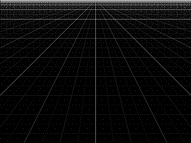

Perspective, Prospettiva, Perspicere
MODE 1
For Y=1 To 480
 For X=1 To 640
   Z=X-320
   If (Z*64)Mod Y=0 Then Pixel X,Y
 Next
Next

Posted: 06:40pm 20 Apr 2025
MODE 1
XR=MM.HRES-1:YR=MM.VRES-1
For Y=1 To YR
 For X=1 To XR
   Z=X-320
   If (Z*64)Mod Y=0 Then Pixel X,YR
 Next
 Sprite scroll 0,1
Next

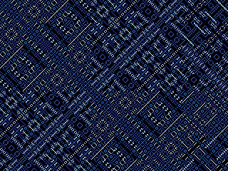

XOR Patterns
MODE 2
R1=Int(Rnd*10)+1
R2=Int(Rnd*10)+10
R3=Int(Rnd*10)+20
C1=Map(Int(Rnd*15)+1)
C2=Map(Int(Rnd*15)+1)
C3=Map(Int(Rnd*15)+1)
For Y=0 To 240
For X=0 To 320
Color 0: Pixel X,Y
K=X Xor Y
If K Mod R1=0 Then Color C1: Pixel X,Y
If K Mod R2=0 Then Color C2: Pixel X,Y
If K Mod R3=0 Then Color C3: Pixel X,Y
Next
Next

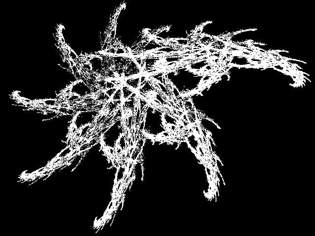

Evil Fractal
CLS
 If Cint(Rnd) Then
   T=(X+Y)/2
   Y=(Y-X)/1.333
   X=T
 Else
   T=(X+Y+1)/2
   Y=(Y-X+1)/4
   X=T
 Pixel 240+X*350,170-Y*290

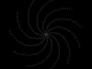

Whirlwind
X0=MM.HRES\2: Y0=MM.VRES\2
 X=MM.HRES/800:Y=0
 Inc I,.1: If i=360 Then i=1
 C=Cos(i): S=Sin(i)
 CLS
 For R=1 To 320
   Pixel X0+R*X,Y0+R*Y
   T=X*C-Y*S
   Y=X*S+Y*C
   X=T
 Next
 Pause 50

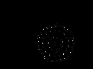

Posted: 02:34pm 11 Jun 2025
Inc I,.001: If i=360 Then i=.001
C=Cos(i): S=Sin(i)
X=MM.HRES/800: Y=0
CLS
For R=1 To 320
  Pixel X0+R*X,Y0+R*Y
