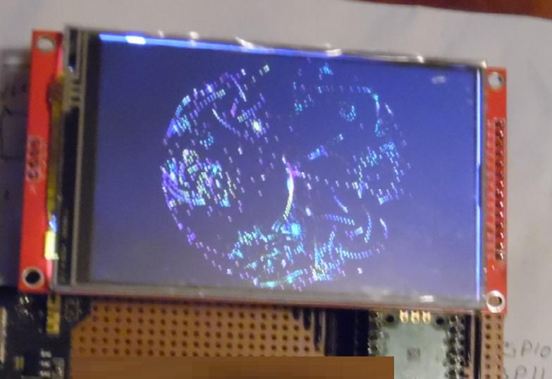

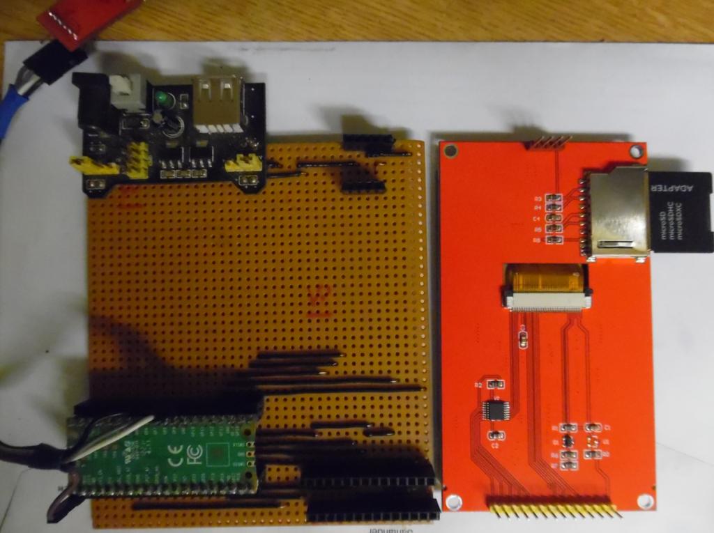

Posted: 05:20pm 03 Apr 2024
Hi, the ips ili9488 arrived and it's bigger than the non ips so the 4 pins at the top you got to solder and find your own pins, overlap the board so just bottom row connected, power up autorun bubble universe and
first noticed the cls ,normally don't
second colours "inverted?" ie black background is white

it's all very dynamic keeping up to latest and easy to miss the relevance of some info imho. like why non ils 9488 is not inverted but ils 9488 is when I never set invert?
anyway it'll need a new board and using vero it'll be two boards side by side cos they don't do big vero and it's expensive.
just remembered a post it's ILS ili9488. I'm testing now and invert setting

Posted: 10:30pm 03 Apr 2024
soldered another header for the size of ils 9488 and tight fit but works. brighter than old ili9488 and wider view angle.
had to option reset to get OPTION LCDPANEL ILI9488, LANDSCAPE,GP15,GP14,GP13,,INVERT and retype other options but works
Posted: 12:46am 04 Apr 2024
the touch and sd card work. poor photo but pixels seem brighter than old 9488.
a side by side comparison maybe one day but £13 it'll be my non vga device.
glad I squeezed it in to existing 9488 strip board with another header, it's about 1CM longer
