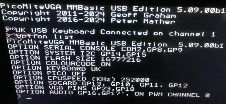

I have enabled COM 2 with :-
Option Serial Console Com2,GP8,GP9

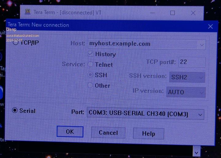

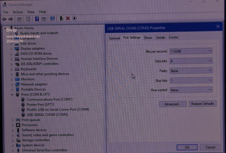

Which has been accepted and is listed in the Options list, however when I connect a USB cable (A-C) to my laptop, I see a USB0 Port appear, but it immediately disappears and I am unable to connect over serial, I have also tried connecting to a PC and I do get a COM3 port, but again I can't seem to connect to it, I get "USB-SERIAL CH340 (COM3)" in Devices, the port reports 9600, Data bits 8, parity None, stop bits 1, flow control none. I am using PuTTY, any ideas as to what I'm doing wrong?

The board was correctly configured and tested when posted and should have worked out of the box. If possible try with teraterm on windows. The serial port is set to 115200.
MAKE SURE THE TERMINAL PROGRAM IS SET TO 115200. It tells the CH340 what baudrate to use on the TTL side over the USB descriptor. This is not the same as a CDC port where the baudrate setting doesn't matter

Current Options.
Device Manager.

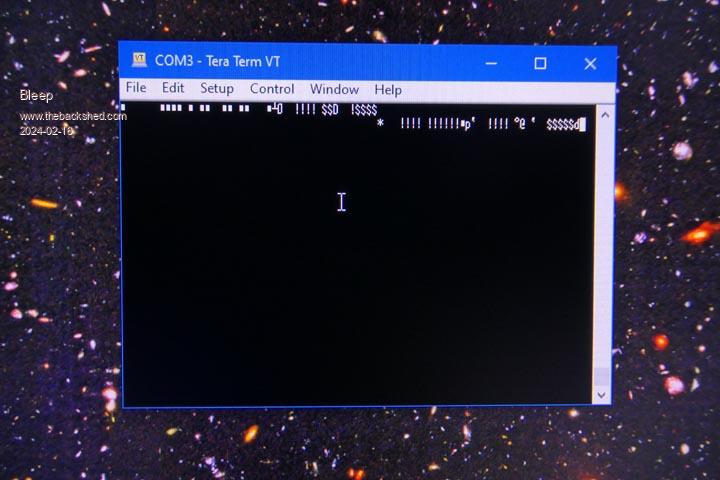

The Tera Term Window, stays completely blank if I try to use the PC keyboard to communicate with it. However I then plugged in a USB keyboard in and got the garbage shown, most keys do nothing, the retun key gave me the white squares, the up and down arrow keys gave me the $$$ and !!! etc.
I have also tried a OPTION RESET, and get exactly the same again.

Posts: 12071
Posted: 05:38pm 15 Feb 2024
MAKE SURE THE TERMINAL PROGRAM IS SET TO 115200. It tells the CH340 what baudrate to use on the TTL side over the USB descriptor. This is not the same as a CDC port where the baudrate setting doesn't matter. It overrides the Windows setting
Bleep
Joined: 09/01/2022
Posts: 867
Posted: 05:49pm 15 Feb 2024
Thanks Peter, that's got it working, I'll continue playing now. ;-)
