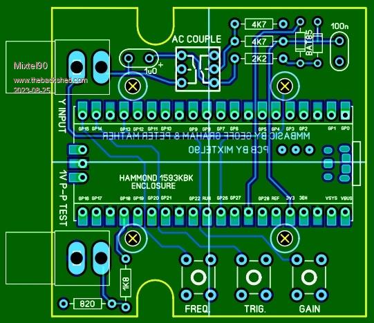

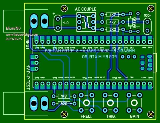

Any use to anyone?
This sort of RCA socket
This version should fit a small, quite cheap (less than 4UKP) Hammond box. The end plates are at the sides. Obviously any buttons will have to be longer than the usual ones, so this may be for those with mechanical skills. If it could be mounted in the cover half then it may be a good version for battery operation.
Edited 2023-08-25 22:28 by Mixtel90

WOW! Absolutely.
What are next steps?
