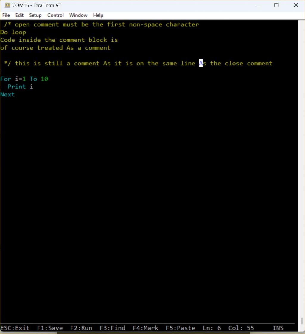

V5.07.08b15
Now includes full support for multiline comments
Use /*  to start a comment
Use */ to end a comment
This should be properly supported including colour coding in the editor but note
/* and */ must be the first non-space characters at the start of a line and have a space or end-of-line after them (i.e. they are MMBasic commands)
Any characters after */ on a line are also treated as comment
I'm quite pleased with this. Note in the editor how the colour coding of the whole page changes as you enter or delete the multiline comment chatacters
Edited 2023-09-04 23:28 by matherp
