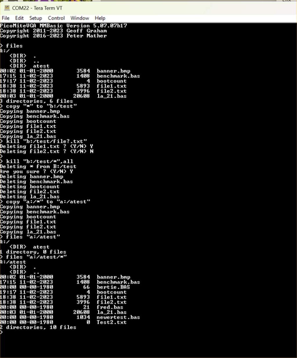

Posted: 06:35pm 11 Feb 2023
V5.07.07b17
Since we now have two disks available I though I'd better improve the ability to work with files in bulk
Wildcards for copy and kill
As in the files command * matches multiple characters and ? matches a single character.
COPY fname$ to dirname$ ' the bulk copy is triggered if fname$ contains one or more  '*' or a '?' characters
dirname$ must be a valid directory name and should NOT end in a slash character
KILL fname$ [,all] ' the bulk erase is triggered if fname$ contains one or more '*' or a '?' character
If the optional 'all' parameter is used then you will be prompted for a single confirmation
If 'all' is not specified you will be prompted on a file-by-file basis
