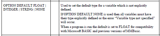

Posted: 11:49pm 07 Aug 2022
Note that with the code shown, you still haven't defined spw, spht, etc. as integers:
> new
> option explicit
> dim spw,spht,spx,spy,sp1 integer
> spw=4
> spw=spw/3
> ?spw
1.333333333
spw is a floating point variable. Please read the manual to see how to specify the type of a variable. (Many people have already shown you correct examples.)

Posted: 12:13am 08 Aug 2022
From the manuals:
OPTION DEFAULT INTEGER
DISPLAY ORIENTATION

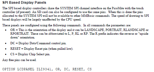

You have portrait mode because that is what you have set.
Following the above instructions you need to change the saved LCD option.
In your post at 07:12 Aug 6 you have:-
> option list
OPTION LCDPANEL ILI9341, LANDSCAPE,GP15,GP14,GP13
OPTION TOUCH GP12,GP11
GUI CALIBRATE 0, 3878, 3882, -881, -647
OPTION SDCARD GP22
remove landscape with
OPTION LCDPANEL DISABLE
Then re-do it with
OPTION LCDPANEL ILI9341, PORTRAIT,GP15,GP14,GP13
As shown in Peter's post just above yours.
You may have to re-do GUI CALIBRATE if the touch co-ordinates are now wrong.
Edited 2022-08-08 17:47 by phil99

  stanleyella said
option default give invalid option error the rest is ok
It doesn't follow the manual, so an error is to be expected!
