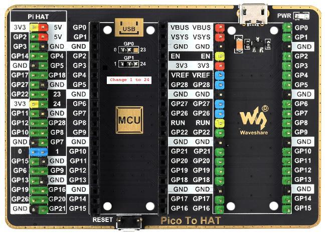

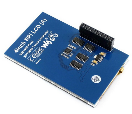

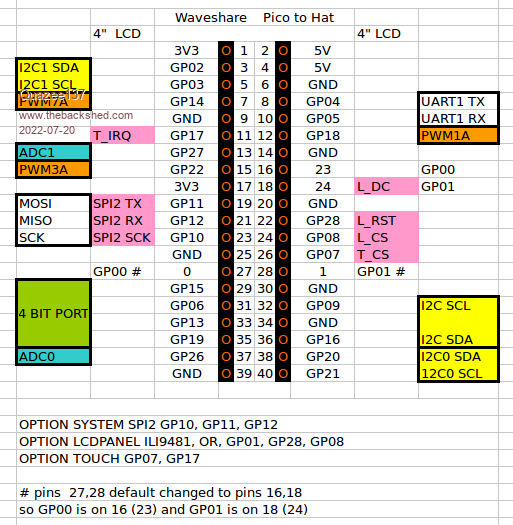

Quazee137
Joined: 07/08/2016
Posts: 603
Posted: 07:30pm 19 Jul 2022
I have been using the ILI9481 Raspberry Pi display on my MM170 hatstands and now
switching over to pico.
Here is a few pic's
I have Peters Clock program running on it.
