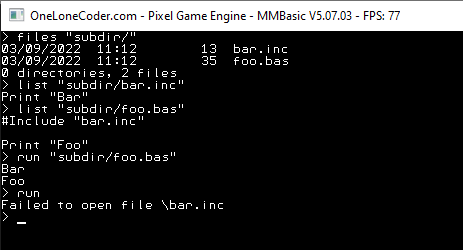

5. This one has been getting on my goat too and I've finally managed to reproduce it simply:
