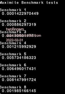

twofingers
Joined: 02/06/2014
Posts: 1784
Posted: 11:24pm 31 Jan 2022
Amazing ...
My results:
Intel Q9400/~3GHz
Edited 2022-02-01 09:35 by twofingers

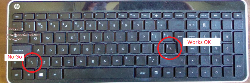

Posted: 02:47am 01 Feb 2022
'Normal' US format keyboards are OK
This one, the pipe/backslash key to the left has no response.
Re running bas file on commandline.
The program opens OK and runs for about 1-2 seconds before closing down.
