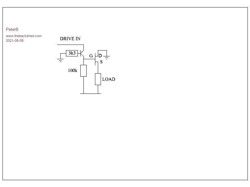

How about this? unfortunately I left -28V off the bottom rail.

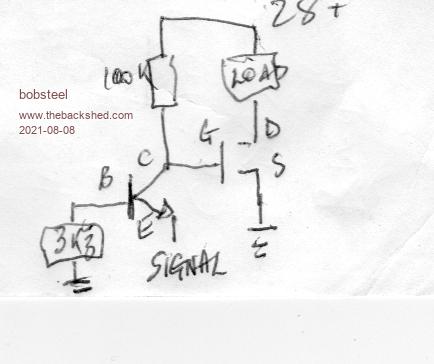

Posted: 07:04am 08 Aug 2021
So I reverse it upside down then for +28v ?
What do I need on the input drive a 10K?
Do I need a zener anywhere?
See from where I've been and whats been discussed I had capacitor ,diode and even a zener at times before . So what can I blow up with this circuit?
Only the Arduino board is really important ,the others I have thousands.

Bob.
That would work for an opposite FET and the ARDUINO would be connected to GND and -5V and you want the load connected to GND.
My cct will work (I hope) but it does mean having a +5V rail for the ARDUINO and a -28V rail for your LEDs. Having two rails is good for noise. Do you have a problem with using a -28V rail? No 10k needed. Would you like a run-down on how it works?
I think it should cost about 25c.
Peter
(my schematics are nicer than yours)
Edited 2021-08-08 17:29 by PeterB

No good. Remember the LEDs are common cathode. That has to be grounded or at -28v. A high side driver is necessary.

Mick.
You had me worried there but you are wrong.
The entire cct could be moved up 28V so that the ARDUINO is between +28V and +33V. You then have a high side driver.
Er, I think.
Peter
bob.steel
Joined: 27/02/2020
Posts: 188
Posted: 08:52am 08 Aug 2021
  Mixtel90 said  No good. Remember the LEDs are common cathode. That has to be grounded or at -28v. A high side driver is necessary.
No I dont agree with that either. It can be high or low as long as the current flows pos to negative through the load lights . I have found that in my trials but getting a clean off seems to be causing the problems hence the bootstrap circuit I used but which inverts the signal so its on when it should be off but its a nice clean on and off.
In light of the comments on power useage being the same on high and low I am going to try inverting the arduino code and that might be an end of it.
If I can follow PeterB's circuit Ill try that too.
Its just getting confusing here now and I need to get something operational.
Thanks to all though!
Edited 2021-08-08 19:03 by bob.steel

Posted: 09:10am 08 Aug 2021
Bob.
My latest (and greatest) can be configured for high or low input it matters not.
You do seem a bit worried about blowing up your ARDUINO so 2 questions,
which ARDUINO are you using
Are you anywhere near OZ. If you are I can send you some mini pro's which would do for testing.
I am confident that my cct. will work but I wish other people would confirm it.
Peter

Apparently the LEDs are common cathode. It doesn't matter how you label the supply voltages, the cathode of the LEDs has to be the most negative. You are feeding positive into the anodes independently in order to light them. Therefore it *has* to be a high side driver. There's no other possible arrangement.
You can feed from 0v to -28v or from +28v to 0v but it's *always* from the high side (most positive) to the low side (most negative). Either way you get the anode of the LED at 28v positive to its cathode to light it.
The sketch that you just posted, Bob, should work fine, but will only drive a single LED. It's no use for common cathode LEDs as you can only connect one. I'm not sure what you are showing with the transistor base, but it should be a resistor to +5v. With SIGNAL high the transistor is off and the mosfet is on.
Interesting arrangement, PeterB. :) The supply *has* to be -28v relative to GND and the arduino supply +5v to GND. It should work, I think... you are getting the gate 5v above the drain to switch it on. The DRIVE in input is "right way up" too. I like it. :)  You can't invert this design with the mosfets you have, Bob.
bob.steel
Joined: 27/02/2020
Posts: 188
Posted: 09:42pm 08 Aug 2021
  Mixtel90 said    You can't invert this design with the mosfets you have, Bob.
OK Appreciate your input . A lot of negativity I see .
So what circuit do you suggest I use ? . Have you actually built any of these circuits in this thread?I have the bootstrap ciruit running without any resistor on the trigger signal . I would have 3 of these circuits on the one board to run 3 LED lighrs .
  PeterB said
I don't know how to build a minus 28 volts circuit peter . My supply is +28v and I will use a DC to DC converter circuit to get 5 volts at this stage and then try to build in a 7805 or equivalent to my final board.
I just don't know how to construct your circuit on a breadboard from what I have available. You know , how do I build a -28 volt supply?
Thanks for the offer . I have some nanos myself and some ATTiny's and 328P chips. The board  am using atm is a Duemilanove but I have a couple of nanos screwed to the board beside it and a few loose mini pros . $3 a piece jobs. I paid about $35 for the duemilanove back about 2015 or so and I blew up another similar doing this a couple of weeks ago. I'm up at Cairns ,on a boat on the reef mostly with a stud cattle home base and a security business if covid stays away long enough.
Ran into an ex hospital nurse recently that tells me covid does not exist and I havent seen any bodies yet so its difficlt to argue with him and fruitless to try. nutters abound .
Edited 2021-08-09 08:01 by bob.steel

bob.steel
Joined: 27/02/2020
Posts: 188
Posted: 10:24pm 08 Aug 2021
  Mixtel90 said  No, I've not built any of these. :)
You have a strange requirement though. Normally people would choose the components to do the job rather than try to lever existing components to fit. I spent many years with that approach though. lol
How are you getting the 28v, Bob?
Does it matter how the 28v is obtained ?
I won't have two separate supplies available only one plus 28 volts
I have said before I have hundreds of N channel mosfets and as I have 20 sets of lights to build ,3 mosfets per board that's 60 odd needed.One ATTiny and maybe one 7805 per board.
Mostly the 28 volts is from LiFePo4 battery supply ,Solar supplied ,some fed off 54 volt supplies ,some off 2 of 12 volt Li Ion 26v  batteries some lead acid . Some from A/C transformed to DC with wall warts.
You are starting to wrankle me because its obvious you have not read through the thread and are just popping in and out with negativity and not really adding or trying the stuff suggested .
I don't mind much usually but keep in mind casting negativity causes doubt in my mind so its sending me backwards and I need to get a circuit settled. See you have not told me how to build a -28 volt circuit or answered my questions at all!
Just criticised .
How can that help anyone trying to learn by asking questions?
I'd really appreciate it if you would just leave it be .
Edited 2021-08-09 08:43 by bob.steel

Bob.
I think Mick was just trying to understand a bit more detail.
I'm doing the washing today so might be a bit slow.
If you start by imagining a 5Volt battery connected in series with a 28Volt battery giving 33Volts end to end.
we can designate any point as ground so we can have +28V & -5V or -28V & +5V or +28V & +33V, it just depend on what we call ground. And that ground is just a local ground. If the 28V battery is a generator or a mains supply or pins in a lemon it can have its own ground. The main point is that we can have our own local ground which could be a Mega volt above some other point, so long as multiple different grounds are not connected. The idea of calling them ground is misleading but that's how it is.
So if you have 2 wires with 28V between them you have a -28V supply. It doesn't matter if that -28V wire is connected to the chassis of a generator and the other wire is red and has a +28V label, as far as our local circuit cares, we have -28V.
The problem is however, given the big range of supplies you have to use, how to generate that +5V supply without spending money. It really does look like the VOM1271 is a good idea.
To understand my circuit you have to stand on your head. PNP transistors need a -ve rail and so are drawn upside down. With the base connected via a 3k3 to GND. pulling the emitter up to +5V will turn the thing on and its collector will go to +5V. Dropping the emitter to GND turns the thing off and it collector will fall to -28V.
In the early days of transistors they were all PNP (OC71) and there were people standing on their heads all over the place.
Peter
