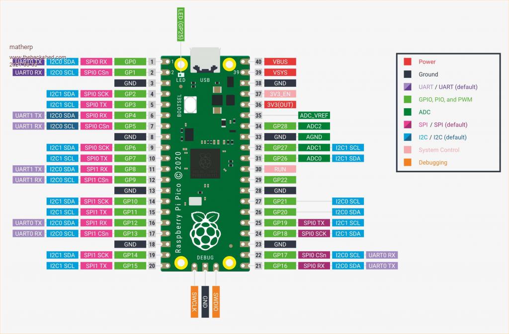

Posts: 12084
Posted: 05:17pm 04 Jun 2021
  Quote  erm... I was kind of hoping for some documentation along the lines of...
That is exactly what I posted earlier
This is the diagram that everyone using a Pico will see. If I lock UART0 to pins 0 and 1 then the "official" diagram makes no sense and people will immediately ask for them on another pairing.
Likewise even allocating a default seems wrong. If I default to pins 0 and 1 but someone wants 21 and 22 then they need to undo the default first. The beauty of SETPIN is that anyone used to MMBasic understands that this is used to configure a pin for a purpose DOUT, DIN, AIN, PER etc. In some ways MMBasic is illogical that the same doesn't apply to UARTS and SPI but that is largely because of the inflexibility of the original H/W (the PIC32 Maximite chip has no flexibility in pin assignment of these functions)
I take on board your various comments but I'm going to side with Mixtel90 - no defaults and use of SETPIN to allocate a function to any pin that can support it
e.g.
SETPIN UART0 21,22
SETPIN SPI1 14,15,16
Note setting up SPI does not AFAIK lock up the CSn pin. CS will be controlled from MMBasic allowing multiple SPI devices on the same bus.
The only deviation from this will be the LCD pins and the SDcard pins. At the moment I'm bitbanging the SDcard pins (same as the CMM2). Experience on the CMM2 has shown that it is much easier to get reliable SDcard access doing this than with H/W SPI and at no performance penalty.
In the case of the LCD and SDcard on the Pico. I intend that these will be flexibly allocated via an OPTION command

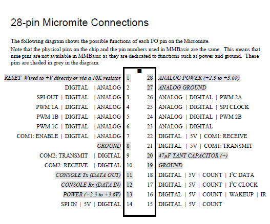

Posted: 09:27pm 04 Jun 2021
That pic is not same thing as it shows multiple instances for each peripheral, with the micromite diagram there is no uncertainty. Newbies are going to look at that and faint.
In the introduction, have a modified version of that diagram showing default positions and then in the advanced programming section that pic above showing all the alternate positions for peripherals and how to remap to them.
Surely applying a default config in the firmware can't be that hard to do in the name of compatibility? Then we are able to simply drop into opening up the I2C peripheral from the word go just like all the other 'mite platforms? I know nothing is impossible for the person not doing the work, but I fail to see why this gets in the way of anything and the plus is immediate access and easy understanding.
... with no defaults, code immediately become non-portable without a PiPicoMite specific setup in MMBasic. it breaks compatibility.
