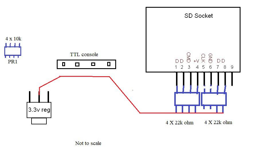

Posts: 3420
Posted: 07:47am 19 Mar 2021
To Andrew_G,
Unfortunately I didn't take a photo. When Peter released that update and Goc30 found it worked I lifted the +3.3V bridge and tried it myself. It worked so well with my SD cards I removed the resistors. Tomorrow I will draw it in Paint and post it.
Before the mods the SD card that had fewest problems was a Kingston 32GB, $11 at the local post office. (AustraliaPost - it's hard to guess where anyone lives, except TassyJim ;)

Posts: 3420
Posted: 12:01am 20 Mar 2021
To Andrew_G,
Glad that is sorted. Peters wizardry works wonders.
It's now redundant, but I thought of an easier option. On the V33 board 4 pullups for the Debug Interface are in an SMD DIL package. Two of them in a size that matches the SD socket pin spacing would have been much easier. It would just require clipping off the unneeded pins. A bit of hotmelt glue would keep it all in place.
Andrew_G
Joined: 18/10/2016
Posts: 910
Posted: 12:26am 20 Mar 2021
Thanks Phil - that is most helpful.
