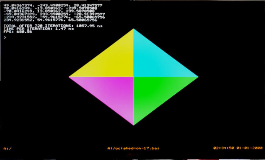

vegipete
Joined: 29/01/2013
Posts: 1186
Posted: 07:27pm 14 Nov 2020
  PeteCotton said  I really like the way you're calculating the smallest box to erase! Very good idea.
Thanks! It cost me a few ms with RC14, but it allowed mucking with the octahedron (and icosahedron) geometry without needing to re-figure out the erasing box. I haven't tested it speedwise with the new release candidates.

vegipete
Joined: 29/01/2013
Posts: 1186
Posted: 07:45pm 14 Nov 2020
  PeteCotton said  I'm at 1043ms (on a 480mhz), so you have well and truely trounced my time   Brilliant work.
Don't be too amazed yet. Peter might just disqualify me for 'cheating' because of some of the loop unrolling I've done. Optimizing for speed and optimizing for size are usually opposite. I've gone deep into the fast and long end of things. For example, my iteration loop contains 69 lines of code/statements.
Btw, could you check which iteration you are printing the vertex coordinates for? Are you saving them at the top of the loop or the bottom?

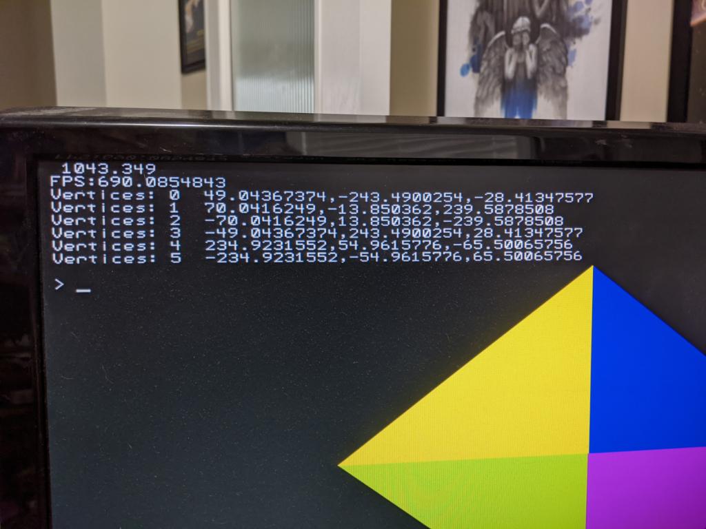

PeteCotton
Joined: 13/08/2020
Posts: 669
Posted: 09:11pm 14 Nov 2020
It's still an amazing feat. I suspect even without the loop unrolling you would still have me beat hands down.
As for the iteration for the vertex co-ordinates, I'm not sure i understand the question?
I start at 0 and run to 719. I take the vertex calcs for iterain #649 (i.e. the 650th based on the zero based loop) - after I have applied the transform. I'm not sure if that's what you are asking?

PeteCotton
Joined: 13/08/2020
Posts: 669
Posted: 09:34pm 14 Nov 2020
  vegipete said  I'm just wondering why my iteration 649 equals your iteration 650.
Ah! you are quite right. I switch so many things around when optomising my code that I often lose track of the simple stuff. When I look at my code I am indeed copying them over before I save the calculation. here's the real 650th ones.

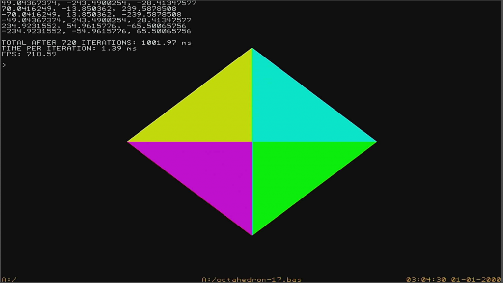

LeoNicolas
Joined: 07/10/2020
Posts: 625
Posted: 10:56pm 14 Nov 2020
vigipete, the credits for this optimization go to you. I reached 1001.97 ms
PS:
I'm not counting the time to print the 650th data.
sub pv(vrt)
 tt=timer
 ... print the vertices
 timer=tt
end sub
Edited 2020-11-15 09:10 by LeoNicolas

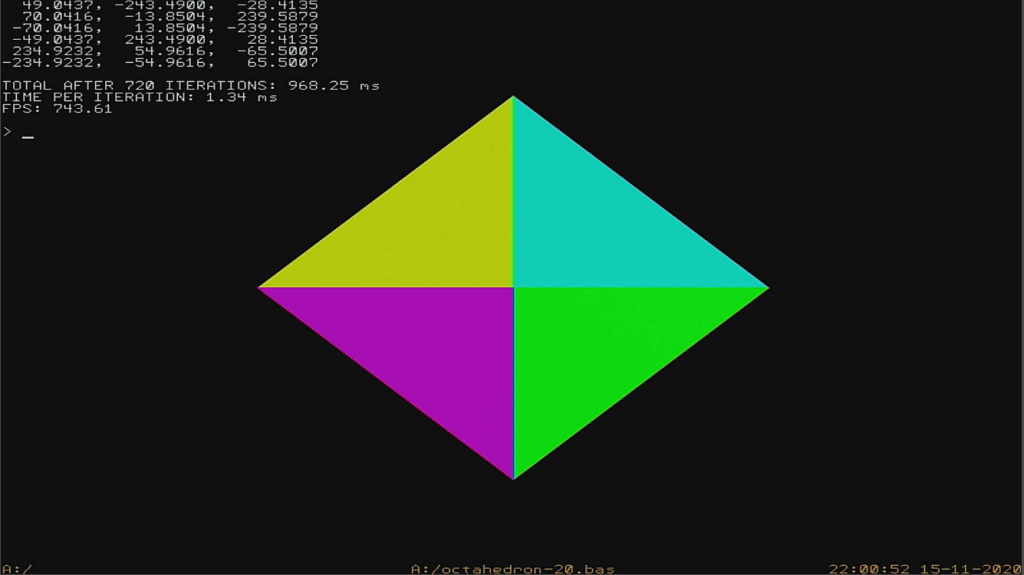

LeoNicolas
Joined: 07/10/2020
Posts: 625
Posted: 02:41am 16 Nov 2020
Finally, I've got an execution time below 1s
Total execution time: 968.25 ms
Edited 2020-11-16 16:02 by LeoNicolas

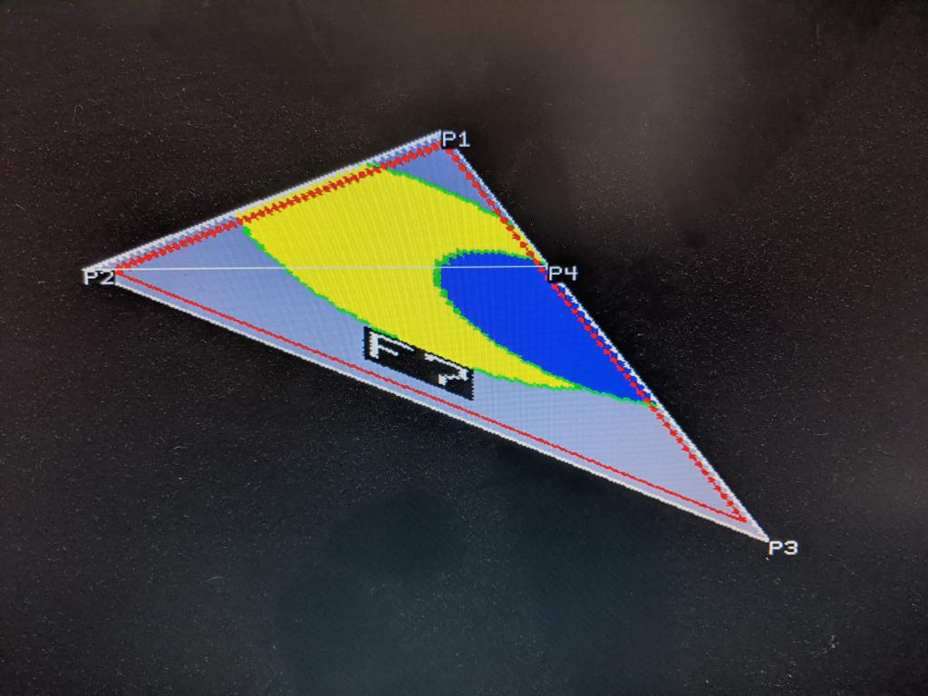

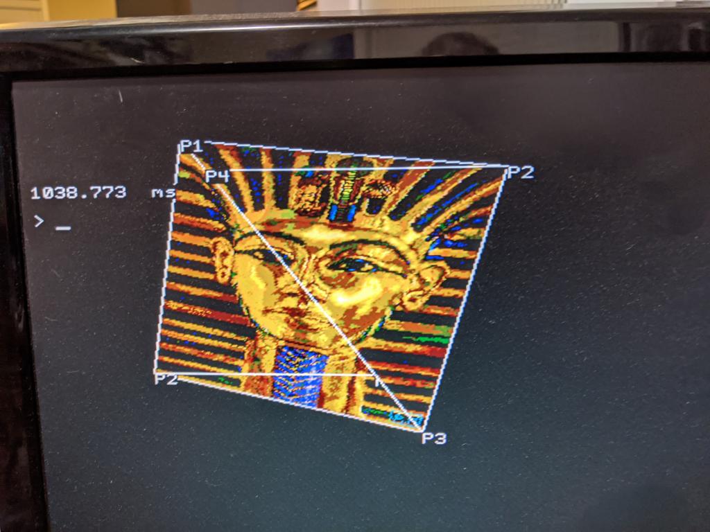

PeteCotton
Joined: 13/08/2020
Posts: 669
Posted: 12:54am 18 Nov 2020
  matherp said  I need the most efficient algorithm to identify the best single pixel in a rectangle to copy.
Just a quick update on this. I've got an efficient algorithm for mapping triangles working well. It turned out to be trickier than I thought due to all of the combinations of source image points and destination points, flipped images etc. But it handles them all well now. Basically throw any 3 destination points and any 3 source points (and the source graphics page number) and it will map it correctly.
The best method I could come up with was to split the triangle in two and draw it as a flat bottomed triangle on top of a flat topped triangle. This allows me to walk down the outside edges of the top triangle, and then walk down the outside edges of the bottom triangle.
In the image below I have drawn in this extra 4th point and the split line between the two triangles. So the top triangle is P1-P4-P2 and the bottom one is P2-P4-P3.
I had hoped to be able to use this to create rectangles by splitting the rectangles in to two triangles (see below), however it distorts the mapped image. (in the picture below the right hand triangle takes up more physical on screen pixels than the left hand one - yet they are mapping the same number of pixels from the source image).
But not to worry, now that I have the triangle code working, it's a simple task to alter it to work with a four sided shape. I will get that working in the next few days.
After I have the rectangle working I will post the code for both functions here. Maybe you guys could improve upon it? Speed it up? Find bugs etc. The algorithm itself is pretty simple.
Edited 2020-11-18 10:55 by PeteCotton

LeoNicolas
Joined: 07/10/2020
Posts: 625
Posted: 11:39pm 19 Nov 2020
Pete, thank you for sharing your code.
Due to the bug with the INC command, my code only runs correctly until the RC20.
octahedron-20.bas.zip
This is my code:
