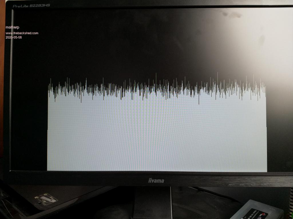

  Quote  I am surprised that there is no facility to seed a random number. It could be useful when trying to get repeatable results for testing (please don't ask for an example right now).
This is really trivial
Try the attached - takes 75 microseconds to run on the CMM2, x is the seed
function pseudo() as float
 static integer x=7
 static integer a=1103515245
 static integer c=12345
 static integer m=2^31
 x=(a * x + c) mod m
 pseudo = x/m
end function
and here is the distribution analysis
Edited 2020-05-08 20:52 by matherp

  Quote   have no idea how or how to use it to generate a series of pseudo random numbers.
Just use it like RND() returns a number between 0 and 1. The sequence is determinate. If you need a different sequence then change the initialisation of X in the function - same as using randomize.
The code is exactly what the C call to rand used in the Micromite firmware is doing. Found it on google and easy to program in Basic
It should run on any Micromite - try it.
My code for the distribution
cls
dim a%(799)
for i%=1 to 800*300
j%=pseudo()*800-0.5 'exactly equivalent to using RND()
a%(j%)=a%(j%)+1
next i%
for i%=0 to 799
line i%,599-a%(i%),i%,599
next i%
do
loop
 static integer x=7
 x=(a * x + c) mod m
 pseudo = x/m
end function

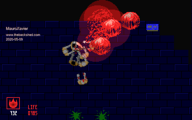

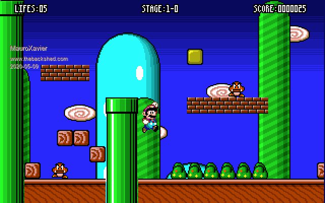

I made various games since DOS, using Borland Turbo C and Turbo Pascal with some assembly routines for speed up things (sprites and mode 13 VGA BIOS direct access).

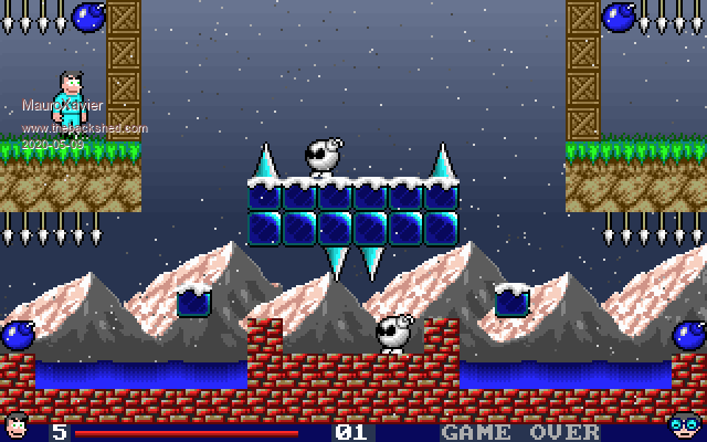

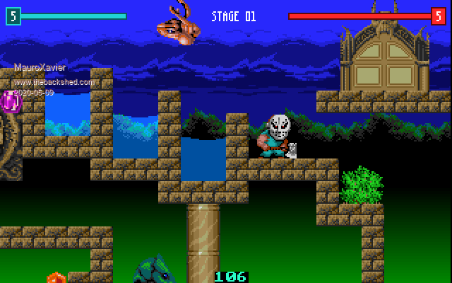

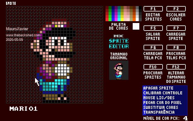

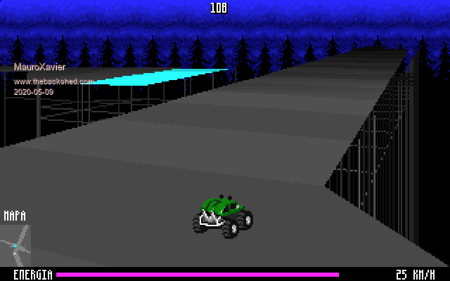

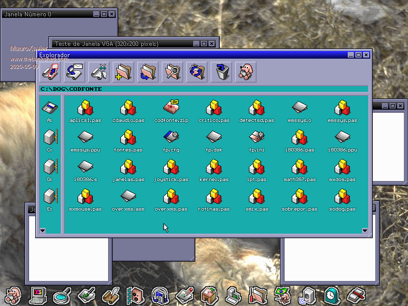

Here are some images of my DOS Games using my "MXMisc" library made in assembly, when I was around 14 years old:
Zombie Arena
Crack Zone
Mario DOS
MXEdit - Sprite editor for MXMisc
MX Racer
Adventures of Mauro & Nohama
And this is a SO developed in Turbo Pascal with inline Assembly. When I developed this I had around 18 years and was my final work for the college.
