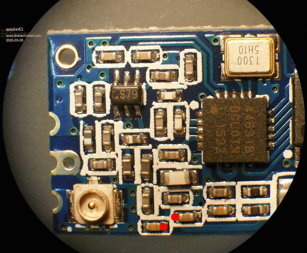

It seems that the reason for the inoperability of some HC-12 boards, which are called clones here on the forum, and think that they are assembled from poor components.
The presence of such boards was reported here by mr.RossW.
But the thing is that such modules have an error on the PCB.
Having received a couple of boards for my project, I ran into the described short-range problem.
In my case, at any set power, the communication range did not exceed 5 meters. Having examined the datasheet on SI4463 and made some measurements, it was found that there is no 3.3V voltage at the pin:4 ic SI4463.
This pin is the TX output and it must have a supply voltage, at which attention is paid in datasheet page 46:
"Transmit Output Pin.The PA output is an open-drain connection, so the L-C match must
supply VDD (+3.3 VDC nominal) to this pin."
 To check, it is enough to measure the voltage at pin: 4. It should be 3.3V
To correct the error, you must make a jumper between the points indicated on the photo.
After correcting the error range is 300m with default settings, I didn't test it further.
Grogster? Can you test this? It would be interesting to know if this is why some modules are "bad".
Posts: 10081
Posted: 11:43pm 05 Mar 2020
Very interesting.  Thanks for posting that, aniskin63 - and welcome to the forums.
@ CG: Yes, I will dig out one of my clones, and make the hack and do some tests.
This might correct the modulation level issue, but I expect they will still be on the wrong frequency, as we have established that the clones use sub-standard or reject crystals, and the frequency is wrong.  However, that hack might allow the cones to at least have a decent range, albeit on the wrong frequency.
I will look into it over the weekend, if I get time.

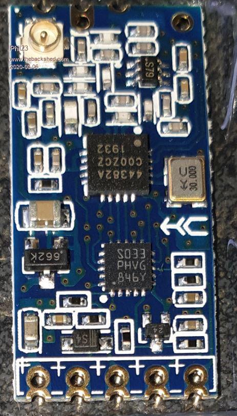

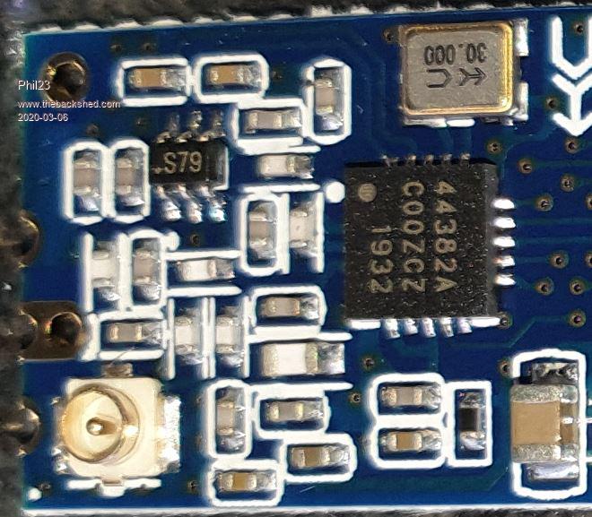

Hi Grog,
The 10 I ordered turned up today. In trays much like one of your pics.
Interesting variation is the crystal.
It's marked HC 30.000.
Maybe HC is getting their own source branded to help with identification.
Edited 2020-03-06 12:42 by Phil23

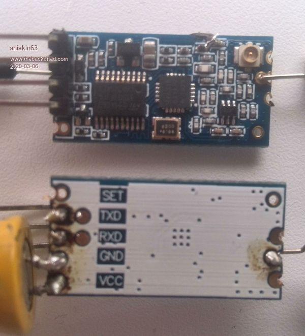

Posted: 02:52am 06 Mar 2020
Had to spin it to compare with the previous pic from aniskin63.
Different layout to the right of the socket.

Yes, that "HC" on the crystal is the HC company logo, so I think you are right!
Never noticed that before.
That will HELP to ID clones, until the cloners start printing that on their reject crystals too.  Hopefully, that is somewhat unlikely, as they would have to spend money to get them marked like HC seem to now be doing, so that might make the clones easier to ID moving forward.  For now, anyway.
Well spotted, Phil!
aniskin63
Joined: 04/03/2020
Location: Belarus
Posts: 2
Posted: 09:26am 06 Mar 2020
There are no logos on my board!
