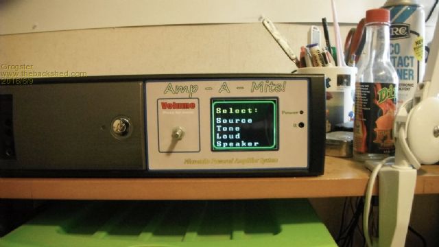

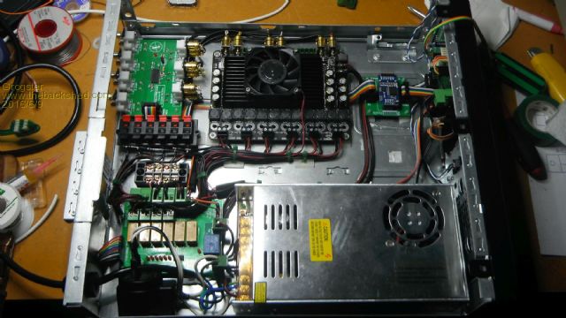

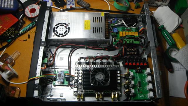

Posted: 07:56pm 08 Jun 2016
The 2nd prototype is finished, but I have not done anything more with it or about it.
It should be noted that jman and HankR helped a-lot with this project. Jman essentially did a page-1 rewrite of the code(wow!), and HankR helped me lots with the audio design side of things to improve the performance etc.
It is my main amp now, and it runs 24/7 and has been for the last couple of months and has never missed a beat - if you'll pardon the pun.
I need to finish this. There is no knob on the rotary encoder on the front panel, and the spectrum-analyser display is not working for some reason. I have emailed jman, but he must be busy with other things - I know the feeling!
Driving the 7419 is easy once you learn the control commands, but it cannot auto-select based on which one has audio, so you would have to think up some kind of magic there, but I am sure it is do-able.

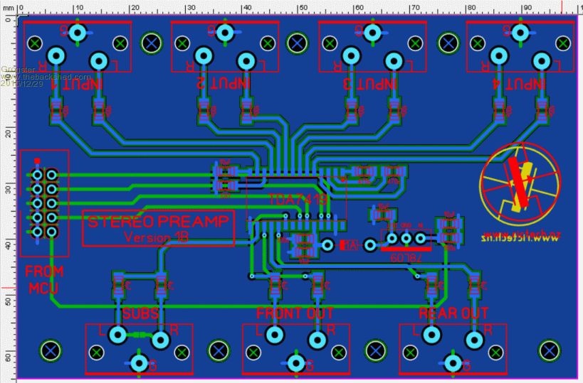

What type and value capacitors did you use for the input and output lines on the TDA7419?
The datasheet shows 100nF for the inputs and 4.7uF for the outputs for the test circuit. Is that the same for a production circuit? What type of capacitors should these be, and what Voltage rating would be best?
I have some of these chips - keen to hook them up and have a play.

I just used what was stated in the datasheet for a start, that being 100n for input and 4u7 for output, yes. 16v MLC's(multi-layer ceramic). Despite 100n seeming pretty low an input coupling cap, the audio seems fine.
In my PCB, I used MLC caps(ceramics), but you could use standard electros, as audio signals are reasonably forgiving when it comes to the coupling caps. MLC ceramics are still a good choice though IMHO.
