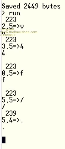

Changed to 511. Result:
As to line numbers, just copy and paste the code into MMEdit for line numbers.

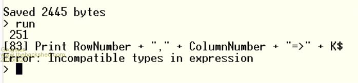

Result:
Current code:

if DEBUG = 1 then
PRINT RowNumber + "," + ColumnNumber + "=>" + K$
endif
Keys$ = Keys$ + K$

Posted: 02:18am 27 Aug 2015
str$()
Posted: 02:19am 27 Aug 2015
PRINT str$(RowNumber) + "," + str$(ColumnNumber) + "=>" + K$
Posted: 02:20am 27 Aug 2015
Getting close. :)

RESULT:
This result is still incorrect - I was typing QWERT.

The lookup table has only placeholders for the right characters.
If you see a 'v' that should be a 'q' then find it in the lookup table and change the 'v' into a 'q'. Repeat for all characters.
This will allow many different kinds of keyboards to be used, just need to put in the right values in the lookup table.
If you wired the keyboard as in the latest matrix, then you can use it to fill the lookup table quickly.
Can you also test holding two keys down at the same time. (Only do this when you have diodes in your matrix otherwise you can short two row outputs)
Edited by TZAdvantage 2015-08-28
Posted: 02:32am 27 Aug 2015
If you were to type eight characters at a time (as per each Lookup string) then TZA's task of populating the matrix becomes easy.
So take the first Lookup characters 'abcdefgh' and press each in turn to show the eight resulting characters.
With all 9 Lookups reported back then TZA can simply put the resulting characters in the correct place in the lookup matrix.
Hope this makes sense . . . .
