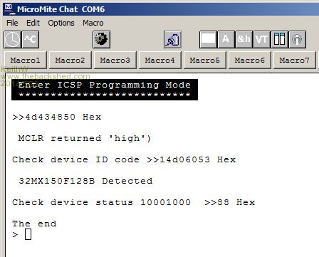

Ok, I have begun to communicate with a chip using ICSP from another MicroMite, a WhiteWizzard board with a 32MX150128D 44 pin to the subject 28 pin MX150F128B’s ICSP connector.
I started with Mobi’s program but have modified somewhat. JTR0701's posts have also increased my confidence. I place the code here to help others get started. Mobi was trying to erase the chip as an early goal but I have resisted that as the PicKit3 has currently gone back to its owner. I can read the chips ID correctly which is a 32 bit number and I think the Status read is OK. Therefore some things are working. I will try to build on this but have a way to go.
I will be grateful if people who are more familiar with MMBasic have a look at my code as I struggle a bit. I have particularly had trouble with using what I had hoped were global variables within subroutines. Finding that they are not visible within the sub? I am trying to minimize processing to increase speed. Using text strings for data seems helpful but may prove cumbersome later.
Geoff, thank you for answering my post regarding creating a small Pclock routine. Perhaps the ability to poke a small machine code subroutine into memory from MMBasic and then being able to call it would be a more universal answer. I think this has been written about before, but have forgotten the status. A method of programming a blank chip would be to put in (using ICSP and MMBasic) a small loader that could then communicate via the subject chips hardware serial port from/to the programmer chip to speed the process. This may be faster than bit banging it all on ICSP.
Whatever, getting some code in is the first step.

From my oscilloscope on the PGEC wire an 8 bit data transfer which uses about 15 Pclock (4 basic clocks each) per transmissions takes 50 milliseconds. With 30 millisecond minimum between the transmissions. CPU = 40 MHz.
Looking at the method used by Kaikkonen the overhead to program is horrendous as it requires about 50 off 32 bit transmissions to load just 32 bits of code. Without reading it back. His method seems to repeatedly load a program in to flash just 32 code bits which is a very slow technique. I may be incorrect but cannot find otherwise yet. Hopefully JTR0701 will tell us that this is not required. The DS6001145(now N) does not use the same method, but without a knowledge of the assembler instructions given it will be a hard grind.

Well JTR0701, now I have found another error. This time within my Xferdata sub. On the third last clock call of this routine TMS should also be 1.
Sub xferdata(st$)
y = Len(st$)
outdata$ =""
clock 0,1
clock 0,0
clock 0,0
outdata$ = Str$(tdo) + outdata$ 'first bit in
For x = y To 2 Step - 1
clock Val(Mid$(st$,x,1)),0 'out
outdata$ = Str$(tdo) + outdata$ 'in
Next x
clock Val(Mid$(st$,1,1)),1 'last bit out ‘******************correct last chr to 1
clock 0,1
clock 0,0
And fixing these errors has corrected an anomaly that had concerned me. I had found that I must call Setmode again between reading the ID and reading the Status to return the correct status. I had tried swapping the two operations but the second still did not work without a preceding Setmode command.Correct code to be: -
Print : Print " Do not recognize chip"
Print : Print "Check device status ";
I am happier now.
Keith W.
