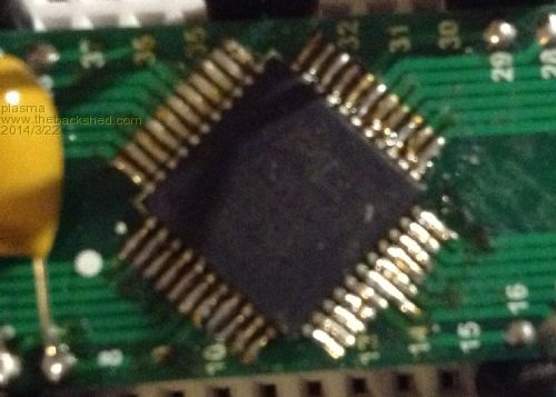

Posted: 01:48pm 22 Mar 2014
my "soldering"
haha my board comes with beta 15
and showed also a personal Message !
whitewizzard : i think it is a good idea to put a link for the usb driver in your description.Edited by plasma 2014-03-23

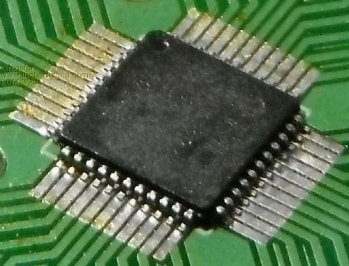

WW(WhiteWizzard) is really onto something with his soldering method.
Here is a photo of a QFP I soldered up using very fine solder and flux-gel:
It's OK, but nothing fantastic. It took me about an hour to get right, primarily as I was concentrating very hard on not bridging any pins.

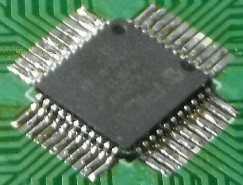

Now here is the same board soldered by me, using the WW method:
This one took about 5 minutes all up so, it really DOES work!

just a word of caution - you might want to leave just a little more solder behind, in case a slightly raised pin is left disconnected. i used to always have a fine sewing needle to hand, and would run the point along the rows of pins; a pin that was not soldered down would produce a more 'dull' ping than the rest.
rob :-)
Posts: 10074
Posted: 05:33pm 24 Mar 2014
Clever use of sewing needle!
Posted: 06:51pm 24 Mar 2014
a trick that arose out of many not-fully-soldered pins being missed! i'd estimate that i've probably soldered over 100 quad packs myself, most using methods similar to those outlined here. plus quite a few FFC connectors and a fair number of CF sockets too, not to mention a thousand or so 0402 resistors and capacitors. oh, the joys of working as an R&D engineer building short prototype runs.
rob :-)

Hi Grogster,
how did you sold your board with the "WW-method"? With flux and solder wick?
Normaly I use a very small soldering iron and solder pin after pin...
Frank
Posted: 09:22pm 25 Mar 2014
Hi Frank,
I can confirm that Grogster did use the WW-method.
The two photos he posted (on page 11 of this thread) show what he achieved on a 'practice' piece of board.
The top photo was the pin-by-pin method which took him about an hour to complete - all BEFORE he learnt my method.
The bottom photo shows his FIRST attempt using my method (after only some guidance via several PMs). This took him around 5 minutes.
Note that NO cleaner has been used in the bottom photo as he didn't have any at hand. If you look closely you can see some brownish markings which would not be there once cleaned.
Overall a fantastic and impressive result for his first attempt.
