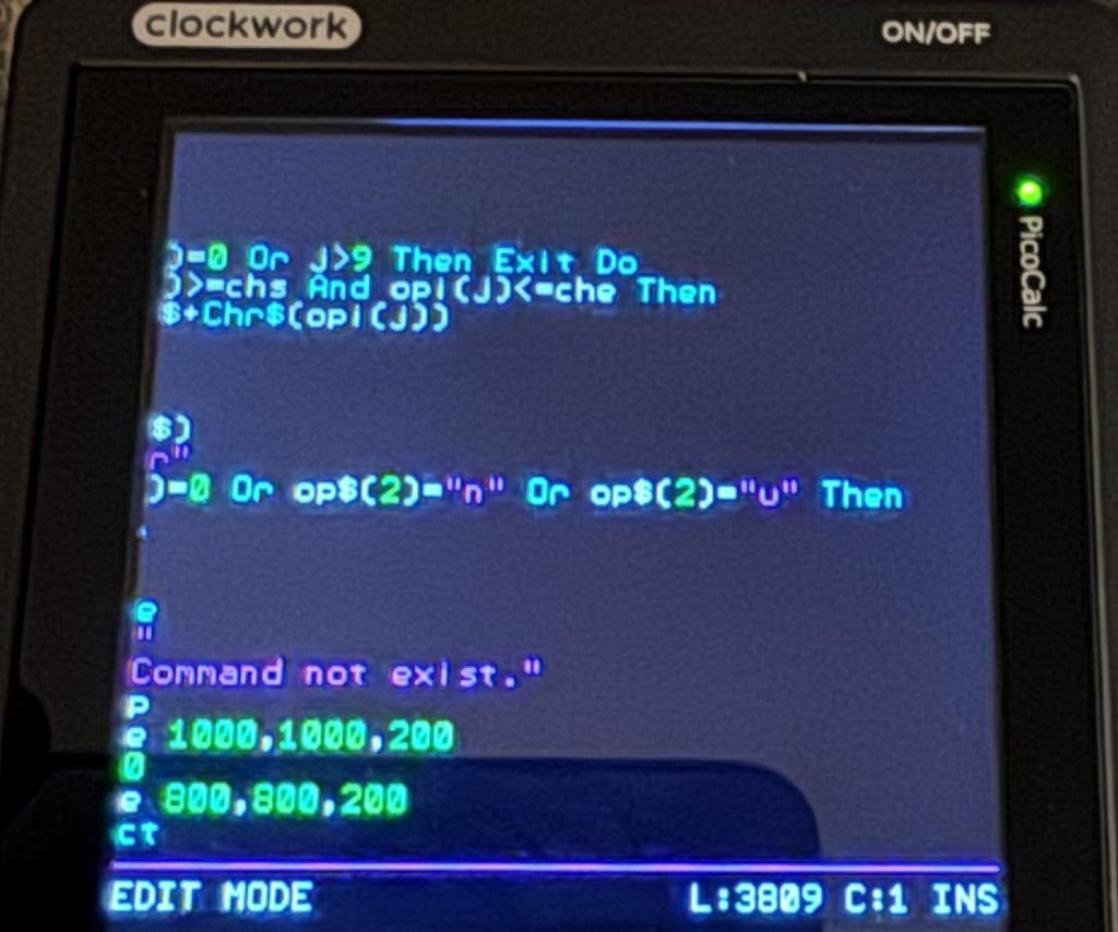

Joined: 02/01/2026
Location: Hungary
Posts: 155
Posted: 08:08pm 19 Apr 2026
@matherp
Peter!
After writing a long line in Picocalc and press Enter I got the attached screen. From here I can’t go back to the beginning of the lines.
Only if I save and reopen editor.
Or pressing shift+Tab (home) twice to go to the top.
G@bor

Posts: 12056
Posted: 09:42pm 19 Apr 2026
terekgabor: will fix both issues tomorrow

Fixes bug in AUTOSAVE CRUNCH
Fixes bug when pressing ENTER in a line that scrolls in the Editor
