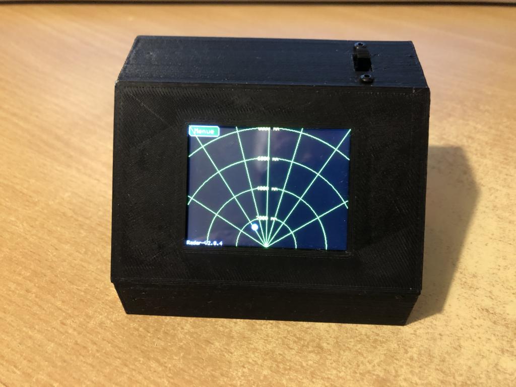

v.lenzer
Joined: 04/05/2024
Posts: 146
Posted: 04:09pm 19 Dec 2025
THANK YOU! It works great!
And this is my little RADAR BASE
In line 320 I added "if cons_char ="M" or cons_char ="1" then text 310,mm.vres-mm.fontheight,cons_char 'shows mode in right bottom corner" (after I took the photo)
Edited 2025-12-20 03:07 by v.lenzer
Best wishes! Joachim
ville56
Joined: 08/06/2022
Location: Austria
Posts: 563
Posted: 06:07pm 19 Dec 2025
Cute little box, nice work indeed.
73 de OE1HGA, Gerald
