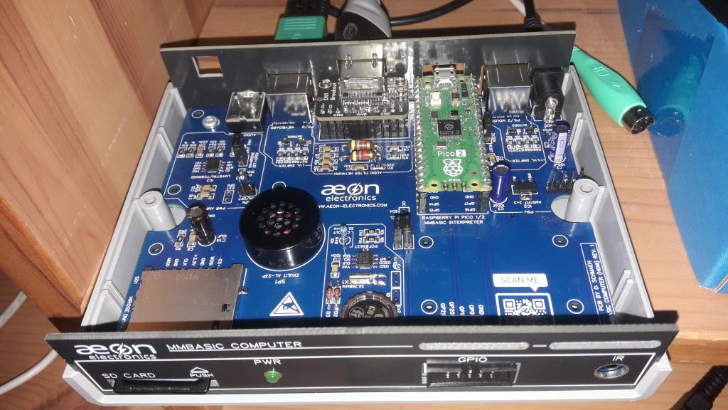

Amnesie
Joined: 30/06/2020
Posts: 763
Posted: 09:49am 25 Oct 2025
  dddns said  Please try to move audio to gp10,gp11
If it fails to gp18,gp19
This isn't possible, I can't re-design all my PCBs:
..and in beta 18 everything works, so there must be some change in later versions.
Greetings
Daniel
dddns
Joined: 20/09/2024
Posts: 924
Posted: 10:11am 25 Oct 2025
I thought so..
But for a test you could just reconfigure audio and see if still crashes
edit:just saw the outside GPs. Can you use these?
Edited 2025-10-25 20:12 by dddns
