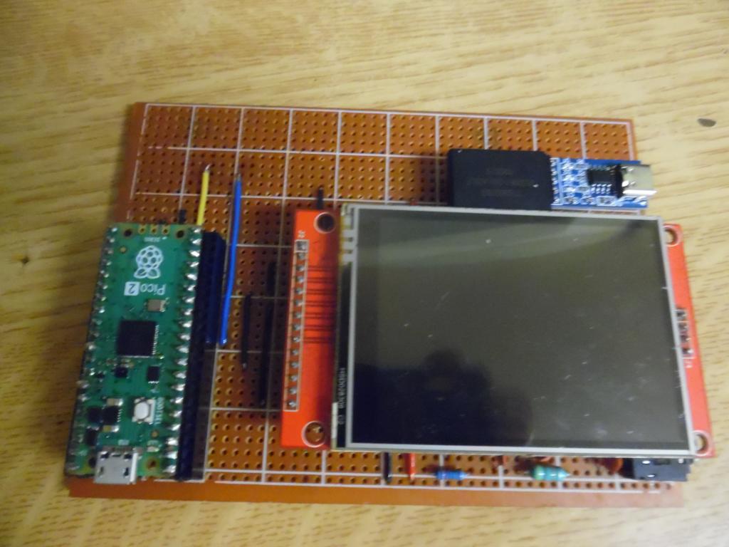

I added usc to ttl so I could usb pico version and added the sound filter,
all works, audio from sd card.
PicoMite MMBasic USB RP2350A Edition V6.01.00b8

why GP0     Boot Reserved : SSD RESET not audio L ?

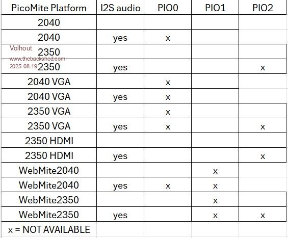

I understood that I2S audio uses PIO0. Correct ? All other audio systems do not use PIO.
Is below overview correct ?

Only I2S uses PIO. RP2350 uses PIO2, RP2040 uses PIO0

PIO2 isn't present on the RP2040 is it?

I2S audio: on RP2350A also uses PIO2 ? Or only on RP2350B. On 2350, is VGA also in PIO2 then ?

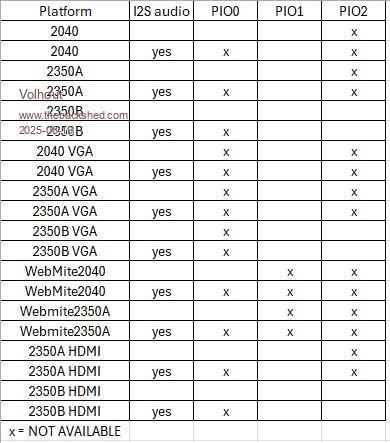

I will update the overview on PIO usage.

Posted: 12:09pm 19 Aug 2025
  Quote  PIO2 isn't present on the RP2040 is it?
No - RP2350 only
  Quote  I2S audio: on RP2350A also uses PIO2 ? Or only on RP2350B.
All RP2350
Edited 2025-08-19 22:10 by matherp

On 2040VGA PIO0 has both I2S and VGA combined.
On 2350VGA PIO2 combines I2S and VGA ? (or do they use separate PIO's) ?.
Posts: 12058
Posted: 01:21pm 19 Aug 2025
  Quote  On 2350VGA PIO2 combines I2S and VGA ? (or do they use separate PIO's) ?.
Separate, for some reason I couldn't get shared to work and in any case it makes it simpler to always use PIO2
Posts: 6197
Posted: 01:28pm 19 Aug 2025
OK, then this should be correct.
