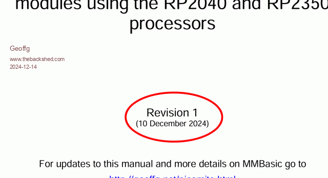

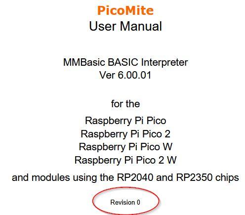

  JanVolk said  Geoff,
I noticed that Appendix J – Advanced Graphics NOT AVAILABLE ON HDMI OR VGA VERSIONS in Revision 1 is gone.
This is an important chapter and if it is no longer in the manual it will be forgotten.
Another point is possibly some more program examples that are on the forum but not in the manual as a starting point for your own program.
Greetings,
Jan.
  Geoffg said  I decided to move the Advanced Graphics stuff into its own own document that will accompany the main manual.  This was because it was rather large.
Good point about demo programs.  I will look into it.
  Geoffg said
  homa said  This would also be a good tip for WebMite:
https://www.thebackshed.com/forum/ViewTopic.php?FID=16&TID=15678
That is good but the best place for it is in the FruitOfTheShed
  homa said  Where is revision 1? I still have the 0.
It is here: https://www.thebackshed.com/forum/ViewTopic.php?TID=17476&P=5#230854
1)
We seem to have talked past each other here.
In your link I find Ver 6.00.01 Revision 0.
Isn't Appendix J - Advanced Graphics included there?
Jan noted that this is missing in revision 1.
Hence my request for it.
There have already been a lot of improvements and I have lost track of everything that has been improved. So I was hoping for a revised version.
Hence my request for revision 1, but apparently .01 from Ver 6.00.01 was meant here! In which case I don't understand Jan's comment.
I am confused. Who can clarify?
2)
Another unanswered question is whether a display driver can be defined in Basic in the mmbasic version for the Pico, as in the link, see above. But maybe @Peter has to answer that please. This is not uninteresting for exotic displays and I would include it in the manual for the sake of completeness.
I hope I have explained myself clearly, English is sometimes too difficult for me.
Matthias

  Geoffg said  Something is not right here.  This is what I see when I download the latest version in that link:
I think you could say that is more than surprising.
I have changed the browser and also used the “private” mode. It remains at revision 0. The link in the first post is: https://www.thebackshed.com/forum/uploads/Geoffg/2024-11-28_215954_PicoMite_User_Manual.pdf
Is that a cache from the ISP in between? The download is in Germany. Do other users from Germany have this problem?
Matthias

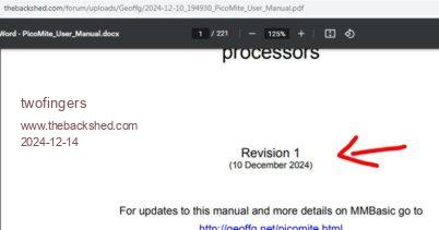

  homa said  ... Is that a cache from the ISP in between? The download is in Germany. Do other users from Germany have this problem?
Matthias
Hi Matthias,
I get the revision 1 from here: https://www.thebackshed.com/forum/uploads/Geoffg/2024-12-10_194930_PicoMite_User_Manual.pdf
without any issues.

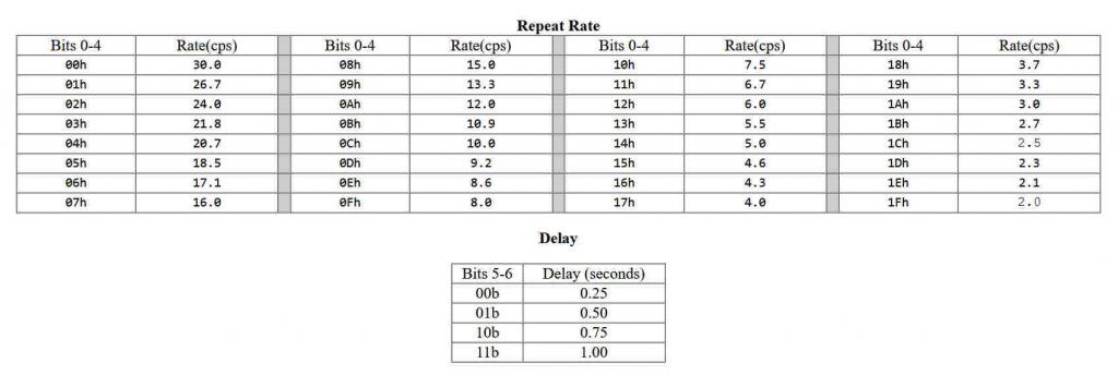

Regarding OPTION KEYBOARD in the manual.
I think you need to reword the end part that talks about the last two optional parameters (RepeartStart and Repeat Rate).
It mentions values of 0-3 and 0-31 but believe it is now the mS value.
However, there is also a OPTION KEYBOARD REPEAT showing in my ‘option list’ -found it in RC7, may have been in beforehand though).
This is missing from the manual and certainly seems to take two mS values for the two parameters. Don’t know if there is any limits on either value though - worth adding into manual.
Posts: 3369
Posted: 12:30pm 14 Dec 2024
  WhiteWizzard said  Regarding OPTION KEYBOARD in the manual.
Peter, can you give me some guidance here?
Posted: 01:40pm 14 Dec 2024
Hi Geoff,
Please also note that the OPTION BREAK nn section in the manual will likely need amending. I posted observations in the ‘….please test thoroughly’ thread) as I think the firmware needs addressing IF the feature is to remain in the PicoMite……
Posts: 12059
Posted: 02:31pm 14 Dec 2024
Option break is a temporary option you need to set in a program. It works for a console and a PS2 keyboard. I missed it for USB keyboards but will add it.
OPTION KEYBOARD REPEAT is just for USB keyboards and sets the time for the first repeat (100-2000) and subsequent repeats (25-2000) in milliseconds
OPTION KEYBOARD applies to both USB and PS2 keyboards. For USB keyboards the parameters work as per OPTION KEYBOARD REPEAT
For PS2 keyboards they are a number between 0 and 3 and 0 and 31 respectively and act as per the PS2 keyboard specification
Posted: 03:40pm 14 Dec 2024
  matherp said  Option break ……. I missed it for USB keyboards but will add it.
Thanks - that will be extremely useful.
Thanks also for confirming the parameters, and option keyboard Repeat.
