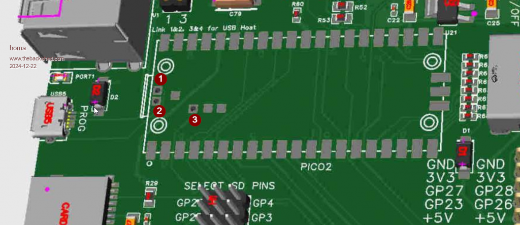

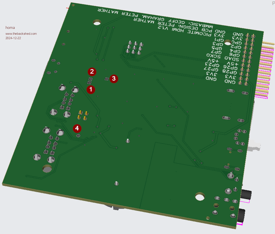

@Peter
Important soldering question!
  matherp said
Notes on use.
Solder the PICO2 direct to the motherboard ensuring it is completely tight to the PCB
On the rear side of the board there are 4 holes without solder mask. Apply liquid flux to these and solder through them. These connect the USB programming micro-USB, Pin GP23, and improve cooling for the USB HUB chip.
Are there really 4 holes or are there only 3 due to the redesign? My board arrived today and I can only see three!
I don't want to make a mistake.
Matthias
Posts: 12056
Posted: 05:13pm 21 Dec 2024
The other hole is under the USB hub - not important - just might help cooling
homa
Joined: 05/11/2021
Posts: 723
Posted: 05:30pm 21 Dec 2024
ok, found it.

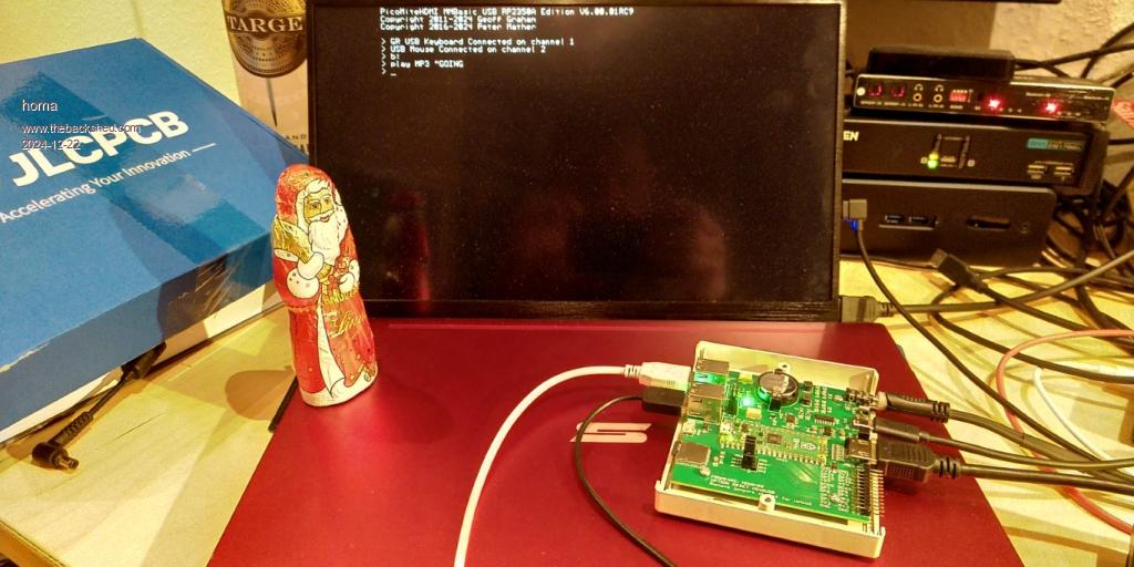

homa
Joined: 05/11/2021
Posts: 723
Posted: 10:31pm 21 Dec 2024
My first board is finished :-)
The apertures are still missing, but I'll make them on Monday with the small CNC.
Thanks to Peter!
Now I'm enjoying my whisky ... and looking forward to it.

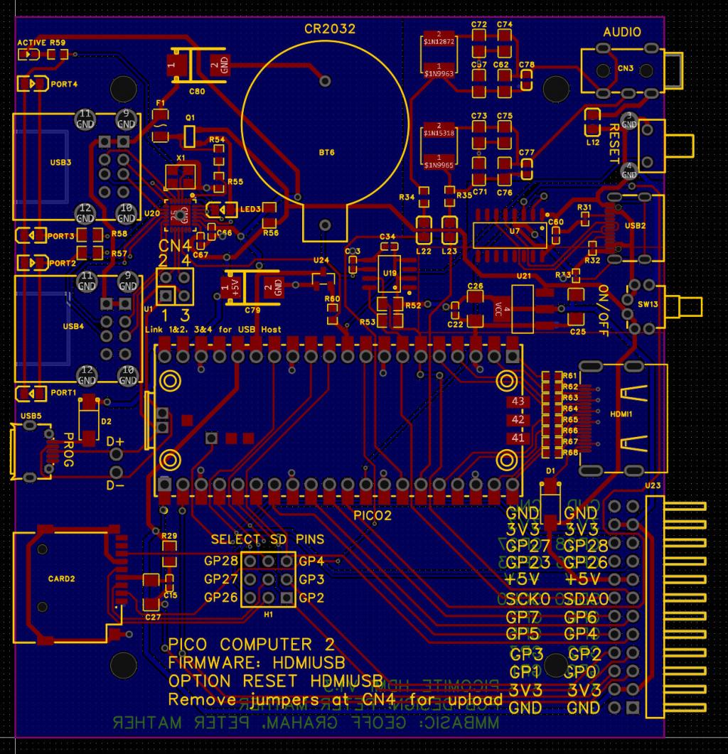

Amnesie
Joined: 30/06/2020
Posts: 763
Posted: 05:44pm 31 Dec 2024
This is a really cool design Peter,
will there be an option for socketing the Pico? Yes I am aware of the fact, that they
are for connecting the USB programming micro-USB! But if you would allow both (just put holes in the pad) then the user can decide whether he wants to put tiny wires onto the pico for those.
Just a suggestion, because you don't really loose anything by doing so, but getting a nice option for excessive pico testing in case it went up in flames
Greetings
Daniel
Posts: 12056
Posted: 10:58am 01 Jan 2025
Here you go. Same BOM and CPL as before
PicoComputer2V1.3.zip
