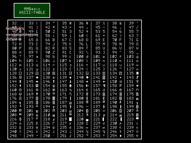

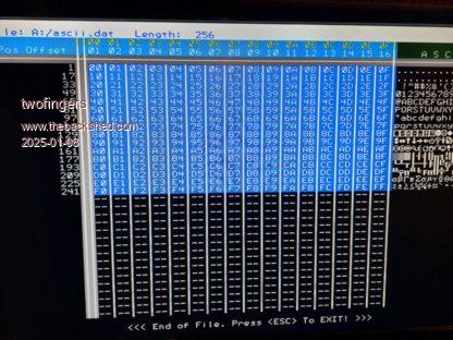

I have modified FM 1.14 with some extensions that I think are useful.
These include Harm's FREEPINS,
and my "ListHex" - for displaying binary files. Called with Shift+F3 -, a color table and an ASCII table (F9).
This is a suggestion and if Vadim also finds them useful then I would be happy if they are included in the later versions.
fm115.zip

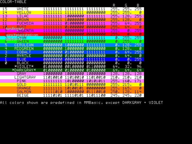

I've worked a bit on the color table:
fm115.3.zip
Note: The colors don't exactly match the screen display of the Pico.

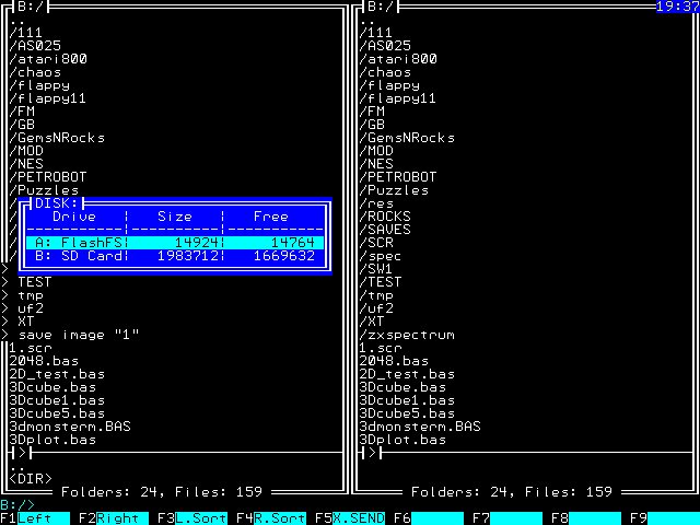

Can you tell me how I can switch to drive B: in the left-hand window? I have not been able to do this yet...
Frank
Posts: 6195
Posted: 09:04am 16 Jan 2025
Hi Frank,
Press ALT F1, and select B
Frank N. Furter
