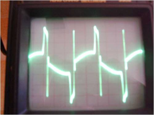

CRO on both outputs from the TL494. Notice the false triggers and severe ringing on one half. No amount of stuffing about will get rid of it.
One turn of wire around the transformer shows this. It explains the transistor heating. It might as well be a sine wave.

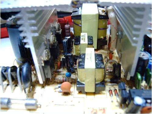

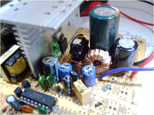

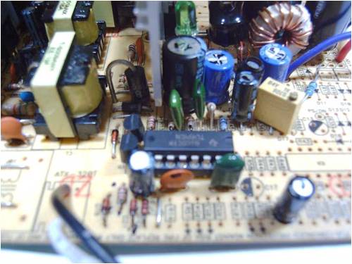

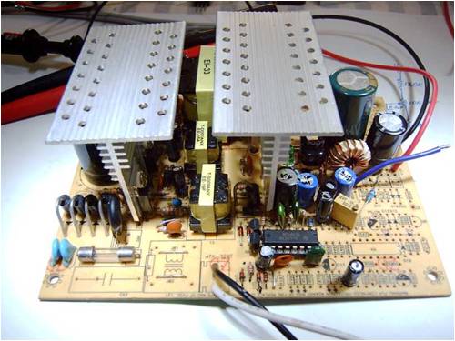

Pics of the PCB:
My home made flyback PSU is cleaner and more reliable than this, and it doesn't even have any voltage feedback from the output to the IC!! Let alone any secondary current limiting!
Overall, I suspect this is a cheap design, which relied on the 120mm fan that was in the case to hold it together. The original design had no current limiting. I'd be better off building my own from scratch.
I'm going to add 1K pull downs to the TL494 output, as I suspect that is where they saved another 2c.
sPuDd..
(Gizmo - the pics all had the same specs, uploading to the server resized all but the first - weird)

Good grief.. those wave forms are a shambles.
Yes the big caps on the feeedback kills the response time, but should have quelled any oscillations in the feedback section, and allowed fault tracing. Don't use it in full time use, as the current response will be too slow to save you. The voltage is not that critical, and a .25 second re-adjustment is usually inconsequential.
I don't know how to help now... it should have been fine. I can't understand how the original is running with that wave form. Something is seriously simply wrong.

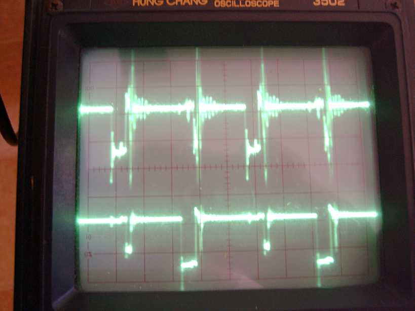

I powered the output from a bench supply, so I could make it run and scope the board. When set it to 13.85V the IC outputs a textbook clean 50% duty (25% from each half) which transpires to a nice clean drive signal all the way to the base of the output transistors. I did notice only 1Vp-p drive to the bases, but I suspect this is OK, considering they only need 0.6V to turn on. Am I right?
The thing turns to sh*t once powered from itself. I've filtered to the wazoo, changed all the caps in the aux PSU, nada. The switching noise that I suspect is causing the problems appears on the output, feedback, aux and Vref rails to the same value! About 1Vp-p, regardless of anything. Its almost as if its being induced through the PCB itself.
Top trace is the output of one channel. Bottom trace is from the centre of the isolation drive transformer. Both are while power from a bench PSU.
I'll have to put this piece of junk aside and try another one.
