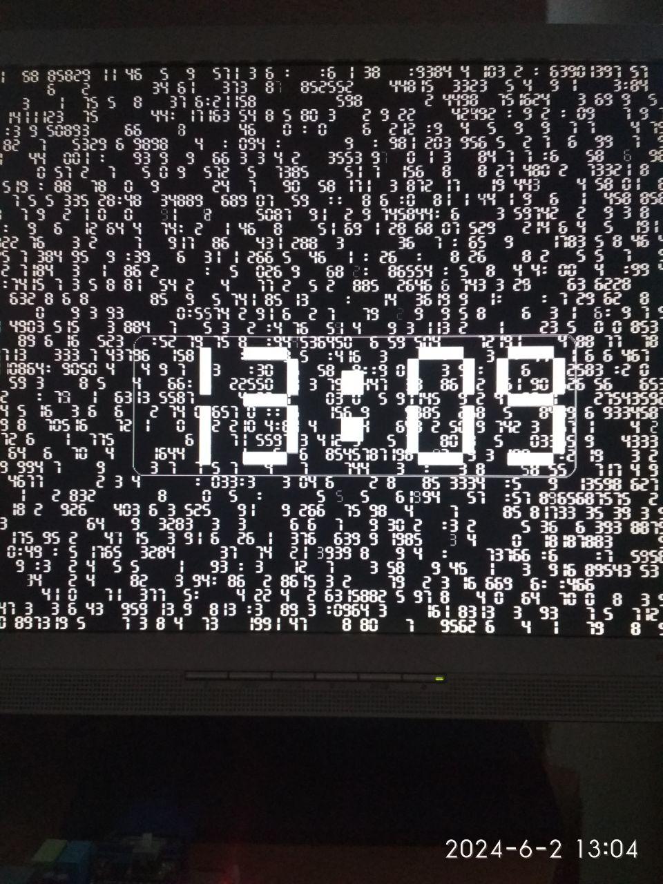

  Mixtel90 said  You can have a sub that runs every second using SETTICK. It's usually accurate enough for most purposes, but not for timing.
Thank you very much Mixtel90  !
Thank you very much Martin H. !
Now the clock is running, I am updating the readings by SETTICK.
7SClock.zip
Edited 2024-06-02 18:22 by javavi

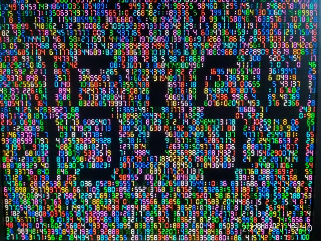

javavi
Joined: 01/10/2023
Location: Ukraine
Posts: 622
Posted: 10:18am 02 Jun 2024
7Sclock2.zip

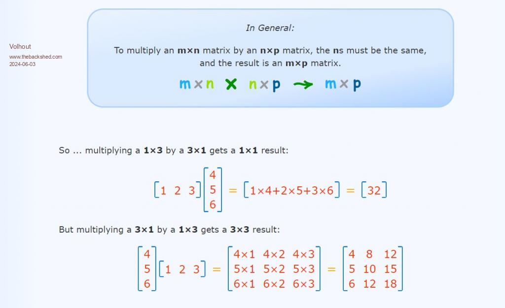

Peter (Geoff),
I have a generic question about matrix multiplication.
In my Thermal imager project I am trying to speed processing up by doing matrix multiplications to achieve higher video resolutions.
But there is something strange in the MATH M_MULT command.
This is the knowledge I have:
Dim a(1,1)=(0,2,10,100)
Dim b(1,2)=(1,0,0,0,1,0)
Dim c(1,2)
Math m_print a():Print
Math m_print b():Print
Math m_print c():Print
Math m_mult a(),b(),c()

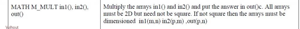

When I try the values for n,m,p (see above) that are according to the text book, I get an error message (array dimensions).
But when I look in the PicoMite user manual I see this:
This implies that matrices in(1) and in(2) are in reverse order in the multiplication ? Please explain how this works ??? Are rows and columns swapped in the MMbasic implementation ? What cells are multiplied by what cells to achieve the geometry specified ?

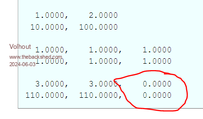

Hi Peter,
With(default) option base 0, the arrays have minimum 2 elements per dimension in the example code (not in the text book copy).
Please try this:
Dim a(1,1)=(1,2,10,100)
Dim b(2,1)=(1,1,1,1,1,1)
Dim c(2,1)
> RUN
  1.0000,    2.0000
 10.0000,  100.0000
  1.0000,    1.0000,    1.0000
  0.0000,    0.0000,    0.0000
  1.0000,    2.0000
 10.0000,  100.0000
  3.0000,    3.0000,    0.0000
110.0000,  110.0000,    0.0000
Regardless how I fill array b(), there are never any values in c(2,xx).
It feels a bit like the code has a good implementation of the text book, just array dimension checking works reverse.
Edited 2024-06-03 17:22 by Volhout

Hi Peter,
Despite the fact that MMBasic implementation of the multiplication is not exactly text-book, I think I can make it work except for the c(2,xx) problem. I have no idea why these cells are left blank.
edit:
with larger array sizes, it seems that all cells that exceed square array are not filled.
